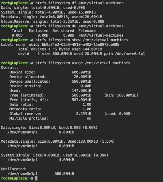

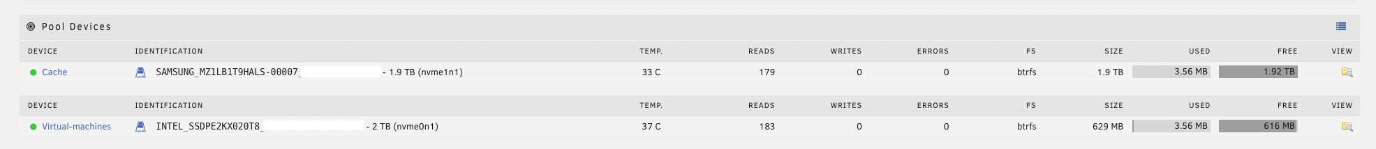

August 2, 20215 yr All, I just installed Unraid on a fresh server with 2 NVMe drives: SAMSUNG_MZ1LB1T9HALS-000077 - 1.9 TB (nvme1n1) INTEL_SSDPE2KX020T8 - 2 TB (nvme0n1) I have no applications/docker containers or VMs yet on this installation. I've created 2 pools, "Cache" and "Virtual-Machines", corresponding to the 2 drives. Unraid is reporting an incorrect free space and device size for the Intel NVMe drive (nvme0n1 and the "Virtual-machines" pool). The device size is being reported as 600 MB instead of 2 TB. Diagnostics are attached. laplace-diagnostics-20210802-1042.zip Edited August 2, 20215 yr by laplace
