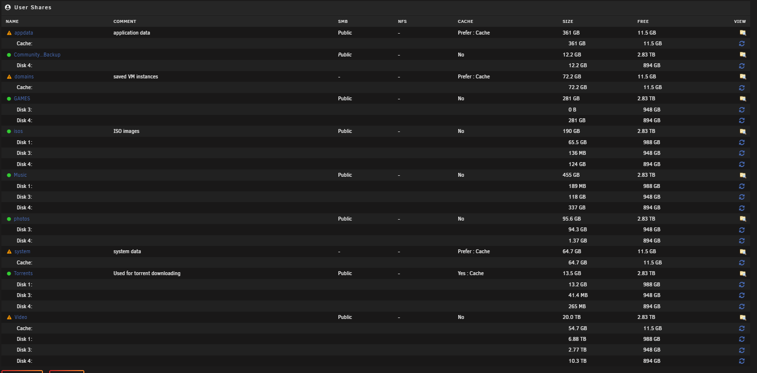

August 9, 20215 yr Community Expert Mover is nothing to do with Docker directly - it is controlled by the settings you have on User Shares. If you post you system’s diagnostics. Up file (obtained via Tools->Diagnostics) this will allow us to see what settings you have specified for your shares. In addition if you go to the Shares tab and use the ‘Computer All’ button it will show you how much of the share exists on various drives (you could post a screenshot of the result).

August 9, 20215 yr Author I had to zoom out a little bit to be able to get it under one screen shot. If you need it larger, let me know and I'll take it again. For the diagnostics, I left the anonymize option checked. If you need it again with that option not selected please let me know. I did, however, before I started with the forums here for assistance, I did reboot but the issue did not resolve itself. I'm not sure if this affects the diagnostics in the same way I read that it affects the logs but I figured I'd be forthcoming so you know what to expect. unraid-diagnostics-20210809-1316.zip
August 9, 20215 yr Community Expert I don't see it even trying to mount docker.img in syslog. I see you are giving docker.img 40G. 20G is usually more than enough and making it larger won't fix filling it, it will only make it take longer to fill. The usual cause of filling docker.img is an application writing to a path that isn't mapped. Many of your disks are very full, including cache. Looks like appdata using the biggest part of cache. How many and which dockers do you run?
August 9, 20215 yr Community Expert Forgot about your "Mover not moving". appdata, domains, system are all on cache where they belong, the only cache-yes share doesn't currently have anything on cache. Mover ignores cache-no and cache-only shares, so to get that Video share moved off cache you have to set it to cache-yes.

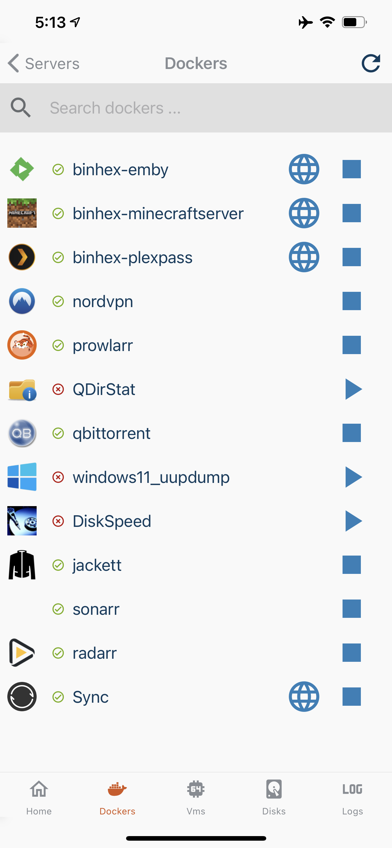

August 9, 20215 yr Author Please forgive the mobile screenshot. I’ve been getting the family ready for a vacation then this appeared lol as for the docker.Img, I have it set to a directory because it kept getting corrupted (I thought). I switched it to the directory instead of the img file. Does that change matters as far as diagnostics?

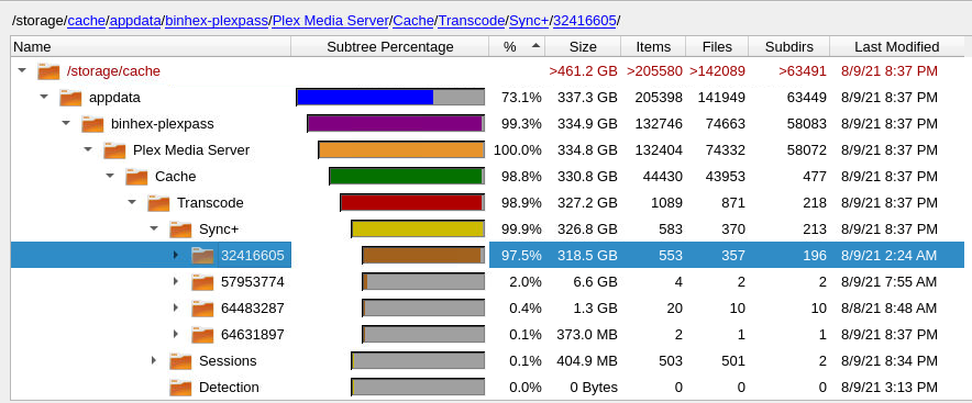

August 10, 20215 yr Author 5 minutes ago, MrCTS said: I have a thought…. I’ve been using Plex to sync content to my iPad for my daughter (my old work hand me down, personally bought) to watch while driving for 12 hours. I’m wondering if the converted/“optimized” media is what’s causing the issue..? I’m going to look into that and try removing it via the Plex settings panel and will update on the results. Apologies for the rapid-fire responses but I may have figured out the majority of the issue. I used qdirstat to find what was hogging the space, as my last update suggested in my thoughts, it appears to truly be the culprit.... Now to figure out how to tell it not to store that here..... Or is there a suggestion for better configuration?? I know this is Unraid support not plex but I figured you miss 100% of the shots you don't take
