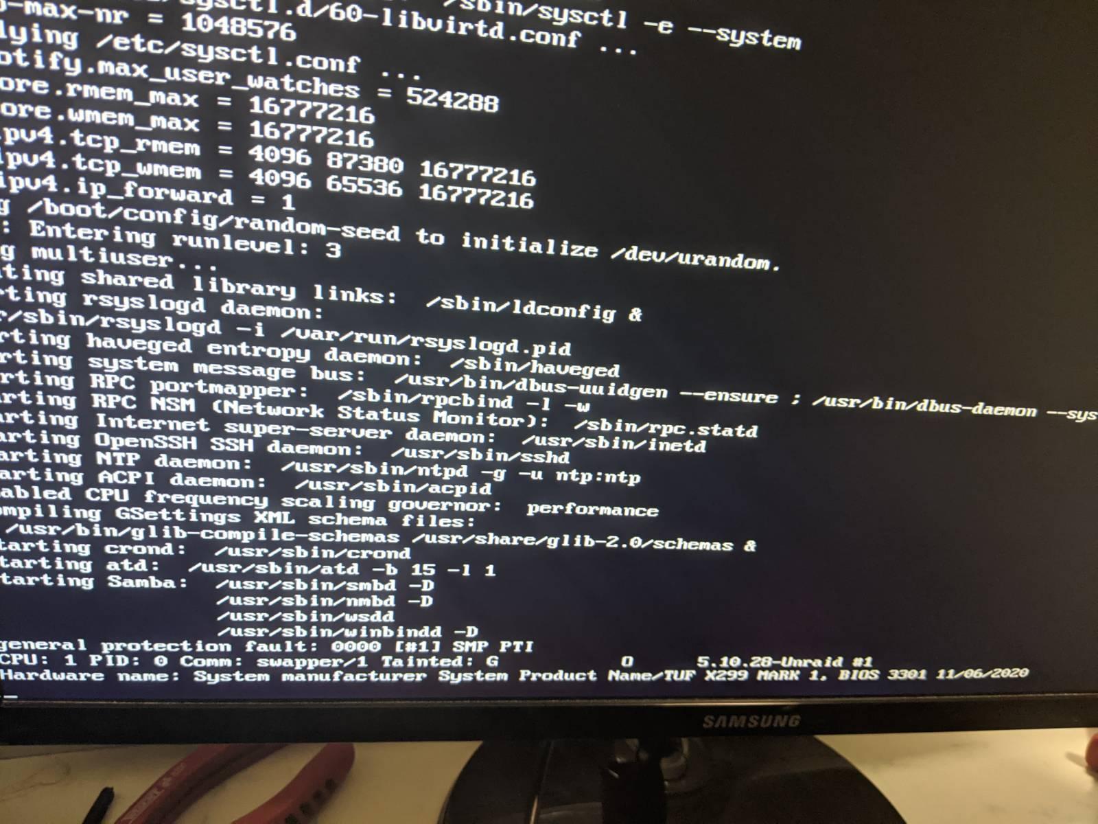

WTF?! I tried to fix the btrfs issues and ran into this...
Please do NOT say "memtest" - the memory is fine, I tested it.
If I do boot in save mode, I don't get any panic... how can I track the issue down?!
Edited by Jaster
SAFE mode doesn't load any plugins, so if it works in SAFE mode, then you need to figure out which plugin is to blame.
