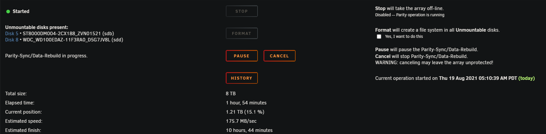

August 19, 20215 yr Hi Guys, I got myself in a bit of trouble. I was trying to replace 2 of my older hard drives with a couple of 10tb drives. While the array was on, I accidentally pulled Disk 5 out, but I plugged it back in right away(not the hdd that I wanted to replace). Then I shut down the array and removed one of the 4tb hdd(Disk 8) and replaced it with one of the new 10 TB hdd(disk 8). Restarted the array and waited for the party sync to start. initially Disk 5 was showing disabled. after the Parity check I have(which synced for Disk 8) restarted the array in the maintenance mode, now it shows the device as emulated while its trying to rebuild the Disk 5. On the main page it still shows both Disk 5 and Disk 8 as unmountable. Now my question is would they both go back to normal after the parity sync? What do you guys recommend to do? diagnostics-20210819-0839.zip

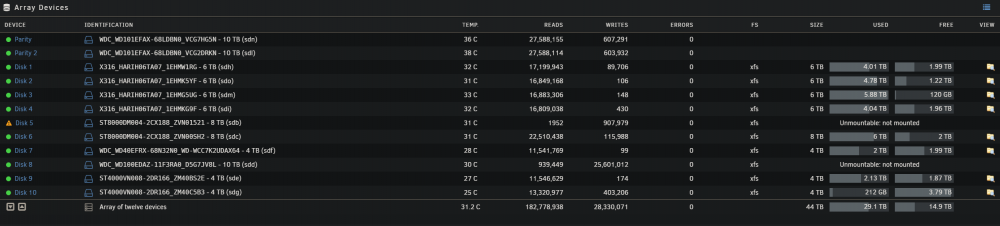

August 19, 20215 yr Community Expert Nothing in syslog to indicate any issues with current disk5 rebuild, but it does show your unmountable filesystems on disks 5,8. I didn't examine SMART for each of your disks. Do any have SMART warnings on the Dashboard page? Since you have already started disk5 rebuild, let it complete, and we can deal with repairing the filesystems after. If there are problems with repairing the filesystems then maybe you can recover data from the original disks if you still have them and their contents. I usually estimate 2-3 hours per TB so it will be a while before rebuild completes. What is the estimate given on Main - Array Operations?
August 19, 20215 yr Author Thank you, I have updated the screenshots. I'll wait for the parity to finish and will update you. So Disk 7 and 8 were the disk I was trying to replace. What happened is, that I unplugged disk 5(didn't count the parity drives on the physical server while array was on - Dumb me!) and plugged it back in right away. Then shut down the array and replaced both 7 and 8. Unraid said it's missing more than 2(Disk 5, 7, 8 ) drives from parity and is unable to fix it. so I replaced back disk 8(original 4tb) with only disk 5, 8 missing I started the parity/rebuild. which did it for Disk 8. After that, I went on Maintenace mode to do the check for Drive 5. and it was giving me an error. I shut down the array and removed the drive from the array and started without disk 5. then turned off the array and added disk 5 again and started the parity check. Btw Disk 5, is the same original disk. it was just unplugged and plugged back in right away. I think it rebuild the array without that disk once, and now it's rebuilding that 8tb(Disk 5) drive again. Disk 7 is the next disk I want to replace after its fixed. Once again, Thank you for your help! Edited August 19, 20215 yr by mdaryabe

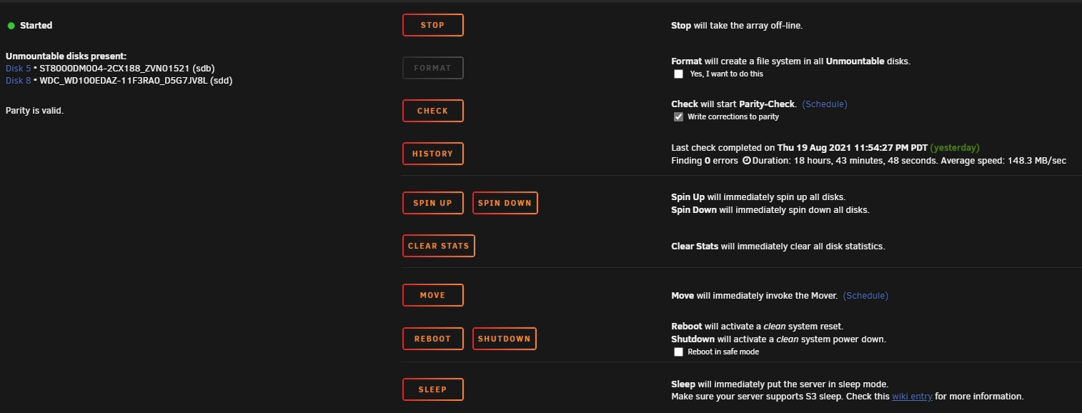

August 20, 20215 yr Author So the parity-checkl/data-rebuild is done on those drives. they both show as green on the main page but they both still say "Unmountable: Not mounted" Do you need an updated log file? Edited August 20, 20215 yr by mdaryabe
August 20, 20215 yr Community Expert 23 minutes ago, mdaryabe said: So the parity-checkl/data-rebuild is done on those drives. they both show as green on the main paid but they both still say " Unmountable: Not mounted" Do you need an updated log file? I guess the next step should be follow the process documented here in the online documentation accessible via the ‘Manual’ link at the bottom of the Unraid GUI for handling unmountable drives. I would suggest that at this stage just run the file system check (I.e. not the repair) and post the results here to see if the recommendation is to to then proceed with the repair.
August 20, 20215 yr Author Disk 5 and 8 both: Quote Phase 1 - find and verify superblock... bad primary superblock - bad CRC in superblock !!! attempting to find secondary superblock... .found candidate secondary superblock... verified secondary superblock... would write modified primary superblock Primary superblock would have been modified. Cannot proceed further in no_modify mode. Exiting now. Should I use the following command for Disk 5 with 2 parity drives? Quote xfs_repair -v /dev/md5 caspian-1-diagnostics-20210820-0844.zip I much appreaciate your help! Edited August 20, 20215 yr by mdaryabe
August 20, 20215 yr Community Expert Yes, and if it then prompts for -L provide that as well. At least the error reported shows why it was not mounting.
August 20, 20215 yr Author Quote Phase 1 - find and verify superblock... Phase 2 - using internal log - zero log... - scan filesystem freespace and inode maps... - found root inode chunk Phase 3 - for each AG... - scan (but don't clear) agi unlinked lists... - process known inodes and perform inode discovery... - agno = 0 - agno = 1 - agno = 2 - agno = 3 - agno = 4 - agno = 5 - agno = 6 - agno = 7 - process newly discovered inodes... Phase 4 - check for duplicate blocks... - setting up duplicate extent list... - check for inodes claiming duplicate blocks... - agno = 0 - agno = 3 - agno = 5 - agno = 2 - agno = 4 - agno = 6 - agno = 7 - agno = 1 No modify flag set, skipping phase 5 Phase 6 - check inode connectivity... - traversing filesystem ... - traversal finished ... - moving disconnected inodes to lost+found ... Phase 7 - verify link counts... No modify flag set, skipping filesystem flush and exiting.
August 20, 20215 yr Community Expert Just now, mdaryabe said: That looks good - running without -n should repair and get you back in operation when you next start the array in normal mode. No corruption is being reported so all your data should be intact.
August 20, 20215 yr Author So I ran "-L" on disk 5, shut down the Array and turned it back on and it seems that it fixed Disk 5, it is now mounted with around 6TB data on it. Should I do the same for Disk 8?
