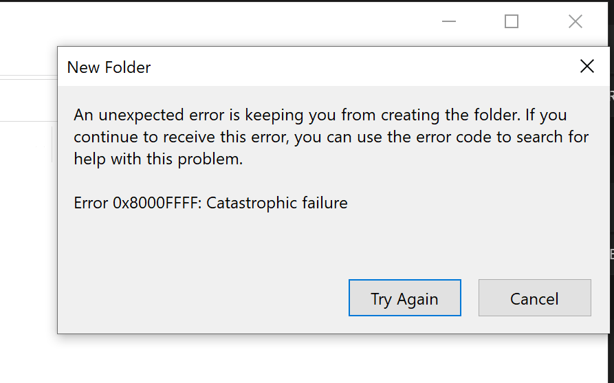

unassigned drive keeps going read only when mounted.. Windows says Catastrophic failure
so i trying to get my rsync to work..  when i ran it its supposed to be going into a log file.. but it wasnt .. it kept saying cant file or whatever is read only etc
when i share my ntfs drive .. and in windows i try to create a file on the drive i get whats in the pic..
i also included my diganostic.. i trying to rsync  to both my 6tb unassigned drives.. but i dont see any issues..  it used to work now i getting this

The diagnostics show the drive has been mounted read-only because it was not cleanly unmounted when it was removed from the Windows system.
