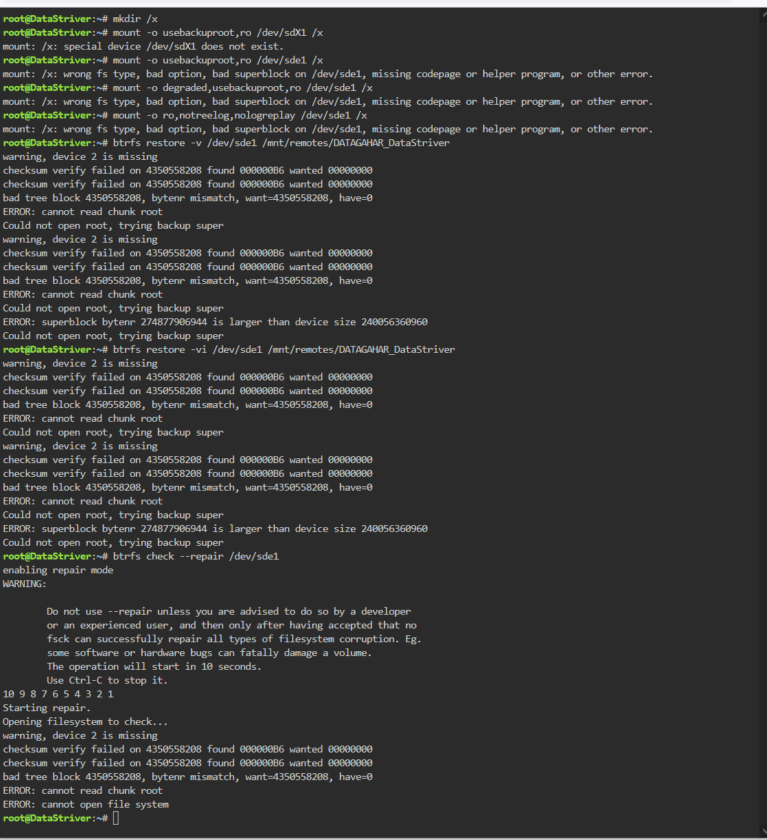

I went through the steps in the thread you showed, and here's the results:
I have both of my servers in the same network right now, and I created a new share in to the main server (called "DataStriver") and mounted a remote share on the backup server to it.
I mounted the remote share, and then tried to do the backup from SSD to the remote share.
I'll throw the diagnostics for you.
datastriver-diagnostics-20210901-1528.zip
Looks like the fs is very damaged, you can try IRC as mentioned in the FAQ, it's frequented by very experienced btrfs users and some maintainers, they might be able to help more, but it doesn't look very good to me.
