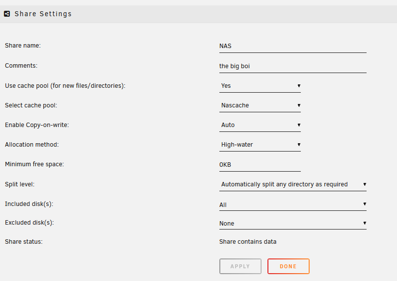

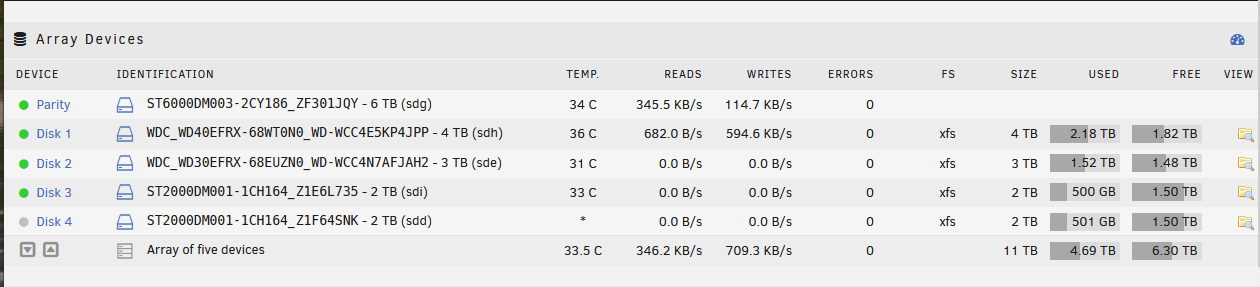

August 24, 20215 yr I'm having some issues with my share access. Whenever I try to browse to my shares, it loads so slow that windows itself stops responding for up to several minutes. This problem happens to all computers connected to it as well, not just one. Is this a known issue/something I have configured wrong? I have a gigabit Ethernet connection with the server, dashboard, vms and dockers seem to run and respond just fine. File transfers to the drive also seems to work okay(but keep in mind that it does have a cache drive). Most drives spin down normally, but disk 1 and parity seems to be active most of the time (this is also the drive that holds most of the data, so I'm not sure if that's why). I've tested both with and without cache drive, and the issue seems to be similar. Cpu usage looks to be normal as well Server is set to local master, and both pc and server is in WORKGROUP Share config: Drives in the array: What the browsing experience is like: ZQCH9r33OJ.mp4 Edited August 24, 20215 yr by Quashera Added more details

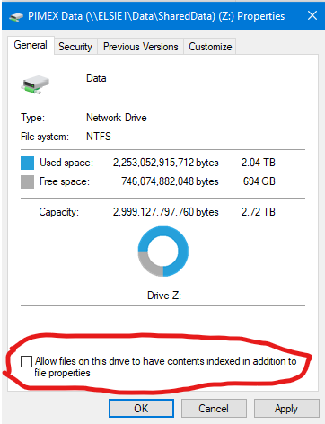

August 24, 20215 yr Community Expert Also be sure that you turn off indexing as shown below: All of these are little tricks to make Windows Explorer a little bit more responsive... By the way, this is a mapped drive from a Share on one of my Unraid servers. Note that Explorer 'thinks' that this drive is formatted as NTFS. (That drive on the server that actually is storing these files is formatted with XFS.) What I am not sure about is when Windows Explorer will decide that it should index the contents of this mapped drive--- When the connection is first established on boot-up or when you actively access the drive with Explorer. One more thing to try. Go into the server from the 'Network' portion of Widows Explorer, drill down, and see what the response times are using that method.
