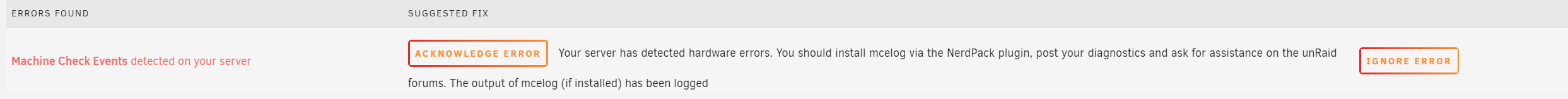

But my system still acts weird. I haven't had a full lockup since disabeling the C states but have had the system randomly reboot. It looked like a clean reboot. I did however, just get this error message:
I downloaded the nerdpack, installed mcelog (I have no idea if that also means that it runs because I can't figure out if I need to start that logging thing somewhere) and downloaded the diagnostics.
Does anyone know what the hardware error is?

The MCE are just after boot and don't continue so they can be ignored.
