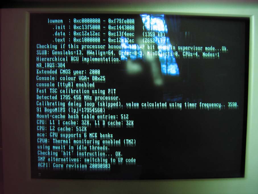

Hello all,
I purchased the parts for an unraid server a while back and finally had the time to put them together but now I am running into a slight problem.  I set the BIOS to boot from USB, I turned off all the other HDD's for booting, I dumbed down the video memory so it uses as little as possible, and I get stuck on the screen in the attached picture.  It gets to the part where it asks me if i want to do a memtest or boot unraid and i select unraid and then get the attached screen.
Parts used
Case : NORCO RPC-4220
MoBo :  SUPERMICRO MBD-C2SEE-O LGA 775 Intel G43 ATX Intel Motherboard
OS : purchased the usb pre installed OS from Lime Tech
CPU : Intel Celeron 430 Conroe-L 1.8GHz 512KB L2 Cache LGA 775 35W Single-Core
RAM : Kingston 2GB 240-Pin DDR3 SDRAM DDR3 1066 (PC3 8500) Desktop Memory Model KVR1066D3N7/2G
PSU : CORSAIR CMPSU-650TX 650W
HDD'sx4 : SAMSUNG Spinpoint F4 HD204UI 2TB 5400 RPM SATA 3.0Gb/s 3.5" Internal Hard Drive -Bare Drive
controler cards x2 : SuperMicro AOC-SASLP-MV8
Cablex2 : NORCO C-SFF8087-D SFF-8087 to SFF-8087 Internal Multilane SAS Cable
cable : 3Ware CBL-SFF8087OCF-05M SFF-8087 to Discrete Forward Breakout Cable
any information would be greatly appreciated.
PS. I also posted in General support but then found this page and #3 sounded like what is happpening to me, I tried slower usb but that did not help :(
I just noticed while waiting on that screen that the network led is flashing
solved by updating the usb stick he sent me to 4.7
