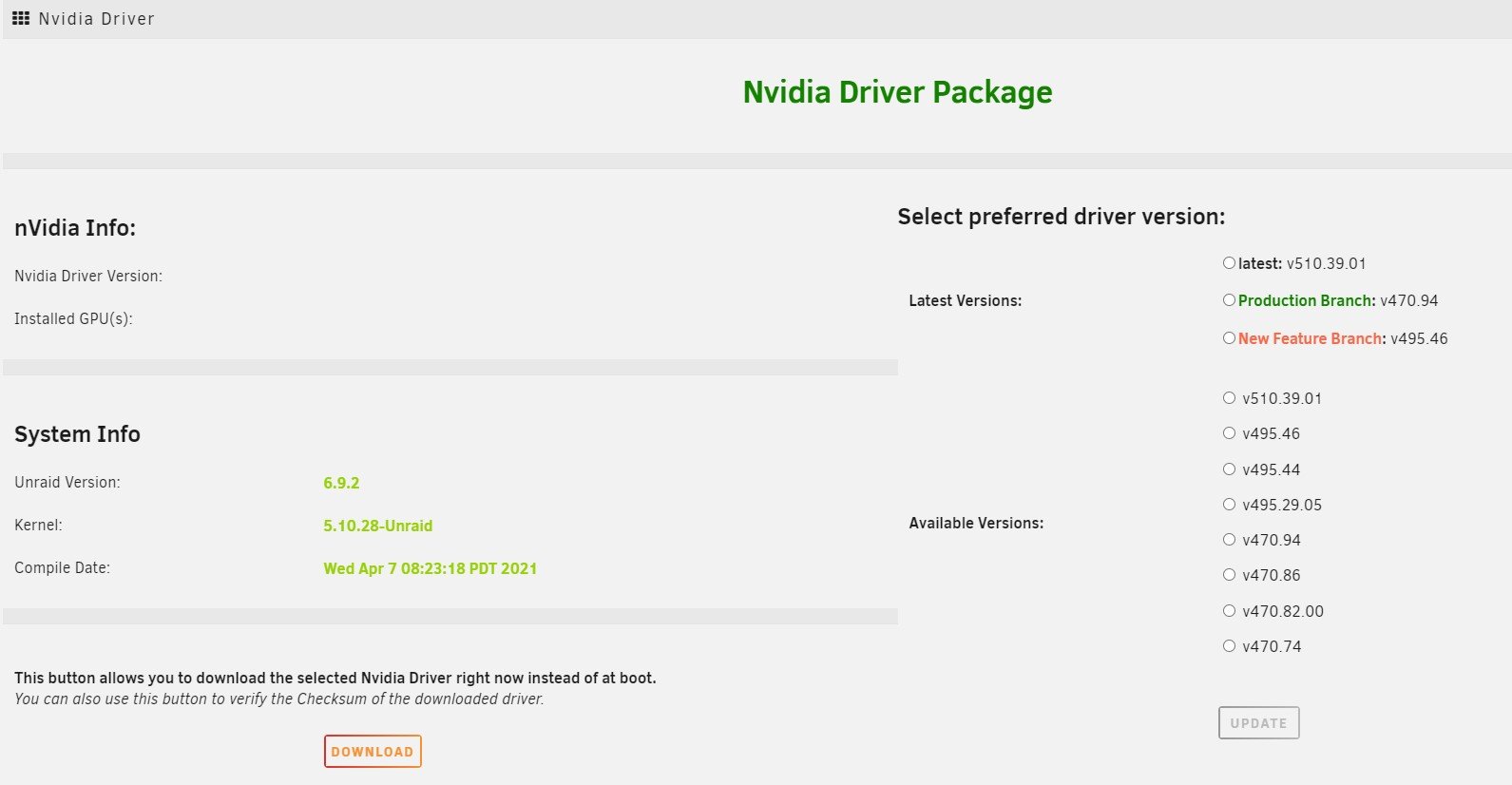

  3. My server has been running for 15+ years and all data drives are on ReiserFS. It's time to convert them to XFS, but I wanted to check one thing first. I have a new 14TB drive which I need to add to the array and utilize to convert my 10TB drives to XFS. I'd like to pre-clear the 14TB, but I don't have any free SATA ports. I have moved all, or almost all, data off of a 2TB drive. So does this make sense: 1) Remove 100% of files from 2TB drive 2) Clear drive and shrink array using Unraid/Spaceinvader instructions 3) Add 14TB as unassigned drive and pre-clear (XFS format) 4) Add 14TB into array 5) Start process of moving data to 14TB, converting drive, moving data back to original drive I think the other option would be to upgrade the 2TB to the 14TB, but then I wouldn't be able to pre-clear the 14TB (or I'd have to stop the array for an extended period while pre-clear runs). Any advice would be greatly appreciated. Parity - 14TBx2 Data - 17 drives from 2TB to 10TB (all ReiserFS) 98TB total storage Cache - 1TB SSD (btrfs) System cache - 480GB SSD (xfs) tower-diagnostics-20240805-0946.zip
  4. That sorted it. Thank you! I deleted the "previous" folder and installed the plugin. This time there was an extra line which hadn't appeared before about the driver being installed, and the process took a few minutes longer. Then the red docker warning box appeared and all was well. Thanks again for troubleshooting. After setting up the driver Plex was still not using HW transcoding. I found in the Plex transcode settings that I had added a transcode directory a few years ago. I think that was to enable RAM transcoding. I deleted that directory reference and the GPU is now doing all transcoding. Noting that here in case anyone else has the same issue.
  5. I'll take another look tonight, but I'm thinking it must be a space issue on the USB Boot Device. It's only 1GB and I've had the same one for years. It's probably near 70-80% full, so that may be preventing the install. I previously tried clicking on Update and trying to Download a new driver, but without success. And I do have a PfSense router with pfBlockerNG installed for adblocking.
  6. Yes, I have waited for the "Done" each time. Don't think I have cut it short. It is not present on the Plugin page and there is no error message. It also doesn't show up as an Installed App in Apps. I reread Page 1 and I don't get the red box regarding the docker restart. So something must be short-circuiting the install, despite the driver showing up in Settings (until I reboot). Attached is what the Driver Package looks like.
