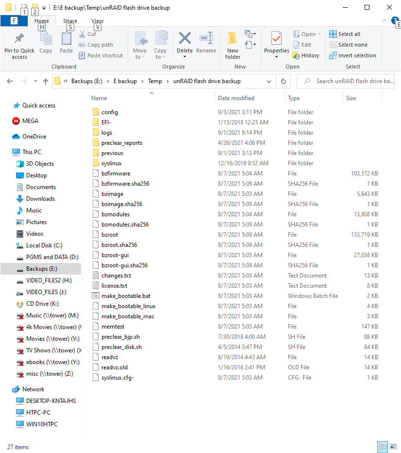

I'm running unRAID Pro version 6.10.0-rc1.  My system was running fine before I removed the USB flash drive to access a couple of eSATA ports located right below it on the rear panel to attach some cables.  I moved it so I wouldn't take the chance of damaging the flash drive.  I relocated it to another USB port on the rear panel and then booted up into the BIOS to make sure it was still configured as the first boot device.  Now it keeps telling me that I need to insert a proper boot device.  I moved the flash drive back to the original USB slot and checked to make sure it was still configured as the first boot device but it still won't boot.  I can see the flash drive internal LED flash when the system first starts up so it's being read.  I've been using the same flash drive ever since I first purchased unRAID back in February of 2008 and it has never failed to boot before.  I don't know if something somehow got corrupted on the flash drive that is preventing it from booting or what. Unfortunately, I have been extremely lax in making backups of the flash drive so the latest one I have is back in 2015.  Here's a screenshot of the files contained on the current flash drive:  I am unable to provide a diagnostics log since it won't boot.
