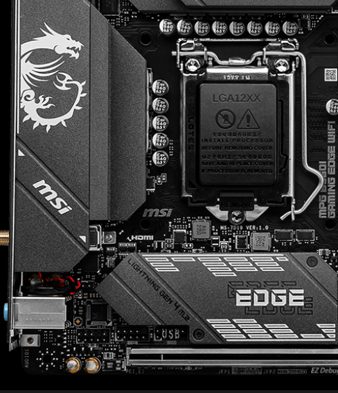

There's a laptop type CMOS battery on the MOBO (visible as attached to the red/black wire in the left lower corner)
Thanks lolight. After removing the CPU cooler I was able to get a closer look and I see the battery. Is there a place where I can get an inexpensive replacement to try?

That was a good call!  Once I took everything back out and got a closer look, the connector for the cmos batter was actually loose.  I reseated it and reassembled everything and now it’s holding the bios settings!
