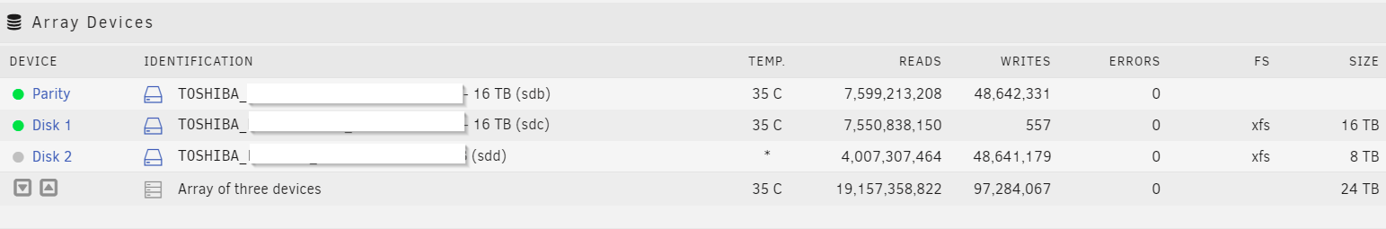

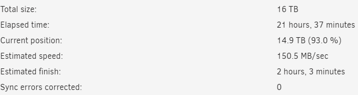

the last Parity-Check discovered several errors, so I started an Parity-Check with ticked correct errors.
It is running smooth, nearly finished an did not correct any errors yet. However, I now realized that the Parity-Check is running only on one disk, the other is spun down. Capacity of the array is also bigger than show in the Parity-Check information.
Is there something wrong?

It's normal since the other disk is smaller, parity check for that one ended at the 8TB mark.
Total size refers to parity size.
