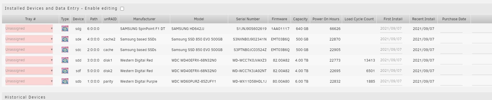

I have read through this https://wiki.unraid.net/Manual/Changing_The_Flash_Device#What_to_do_if_you_have_no_backup_and_do_not_know_your_disk_assignments but not being well versed in unraid I didnt want to do something and end up loosing data. I am not sure if there is other data other than the drive configurations on the flash drive. I think the plus to this is that I believe I do know what the disk assignments are with the attached screen shot.

If you know your disk assignments your data should be safe even if you have to start from a new install or new flash.
Everything about your configuration is in the config folder on flash. If you have to start over without your config, it won't remember your disk assignments, or any other settings you have made in the webUI, including your docker templates. You will still have docker appdata, but you will have to set them up again to use that appdata.
Your license .key file is also in that config folder.
So it will save you a lot of trouble if you can get config folder from that flash or a backup. As long as you don't assign your disks wrong your data should be fine.
