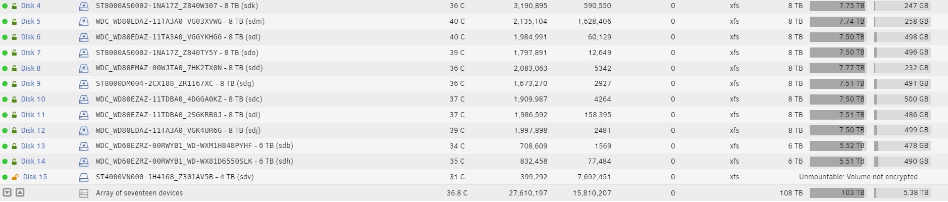

I added a disk, it belonged to the array a while ago and has been sitting on a shelf after an upgrade.
After adding the new disk, I started the array.  Unraid said it was unmountable because it wasn't formatted (it was, I mounted it and read files just fine).  So I clicked the format box and now it says its unmountable because its not an encrypted volume.  But if I click on the disk it clearly says its "XFS encrypted."

All were mountable via the new "mount" button (used to use unassigned devices) except one drive, for some reason it wouldn't mount but was recognized.  I added one of the drives to the array after stopping it, and then restarted.  That's when I got the format error.  Formatted it, and now am getting the not encrypted error.
The disk is showing up in the list of array members, however it is not mounted.  Yet I am getting green balls and assume parity is valid.  So I'm not sure what is happening.

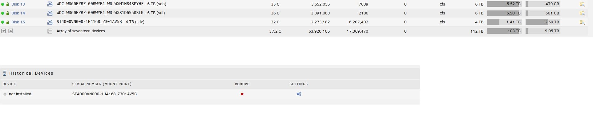

That worked.
But now the disk is showing up as added, and not added.....
Those are historical devices, you can click on the red x to remove it from the listing.
Or you can hide historical devices using the slider at upper right.
