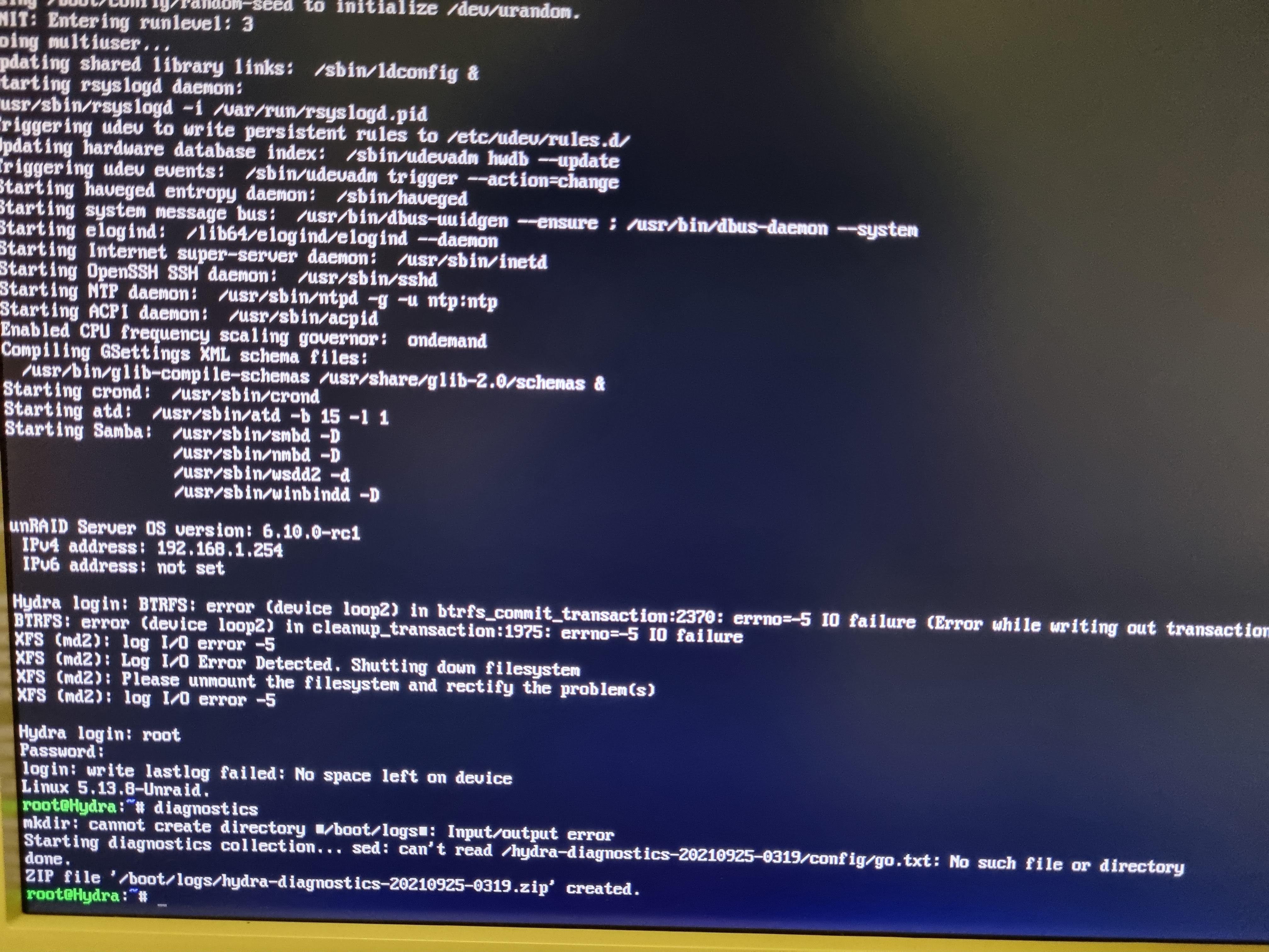

And sadly another crash and another time I can't create a diagnostic file:
Edited by Martinxds
At least get the syslog:
cp /var/log/syslog /boot/syslog.txt
Thanks from now on when it can't get the diagnostic file I'll grab the syslog :) .

Unfortunately crashed again without the ability to create a diagnostic file also means the CP command doesn't work with an error:
cp: cannot create regular file '/boot/syslog.txt' : Input/output error
Is this potentially a USB issue? It is a brand new USB but I'm going to backup the config and format and restore it.
