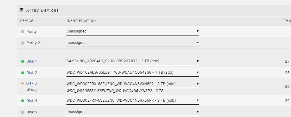

Hi Guys,
New to unraid and it was running fine until installed a new harddrive and had to swap a sata port on one of the existing drives.
Now it shows up with the error as per screen shot below, is there any way to recover this?
thanks

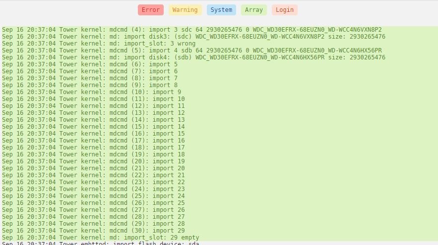

Sep 16 20:26:05 Tower kernel: ata3.01: HPA detected: current 5860531055, native 5860533168
Sep 16 20:26:05 Tower kernel: ata3.01: ATA-9: WDC WD30EFRX-68EUZN0,      WD-WCC4N6VXN8P2, 82.00A82, max UDMA/133
Your board is creating these:
Also change SATA controller from IDE to AHCI/RAID.
Forgot to mention, you have other disks with HPA enable, but don't remove it on those or Unraid will also complain the disks are wrong, but now because they are larger than they should be, only remove on disk3 and disable that feature on the board BIOS so more are not created.
