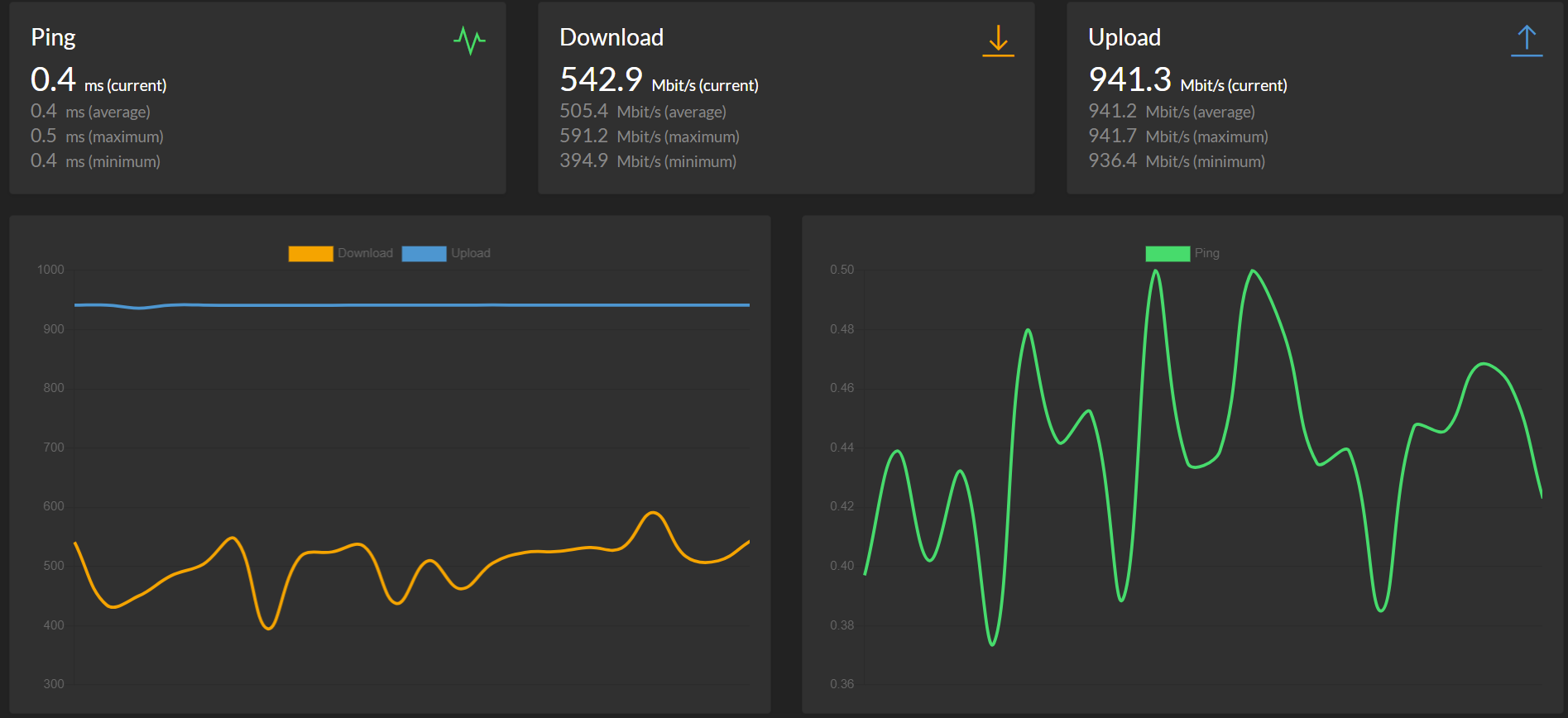

EDIT: One more thing, that great Gb connection may not be so great if a large number of your fellow residents decide to use that connection!
I mean so far it's really great (what a waste would it be not to use it for unraid...)
