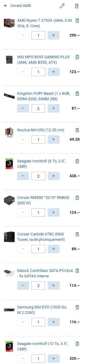

- Attached is the hardware config I'm planning on getting, would you have any replacement/add suggestion to fulfill my use case ?
- Can I configure the volume only with three disk and copy my Data's from existing NAS before adding the two remaining drives ?
- What's are the standard service to be able to access files from a web GUi and have user management enabled ?
Planned config :
- CPU : AMD Ryzen 7 3700X + Noctua NH-U9S  (choosen for virtualisation capacity)
- MB : MSI MPG B550 GAMING PLUS (globaly fueature set)
- RAM : Kingston FURY Beast
- SSD : Samsung 860 EVO 1TB  (for caching mainly, overkill ?)
- Expansion card : Delock Contrôleur SATA PCI-Ex4 - 5x SATA3 interne
- PSU : Corsair RM850 *2019* RM850
- Case : Corsair Carbide 678C
- Also, my LAN is 10GBs capable, would it be worth to add a 10Gbs NIC ?
- Disks : Seagate IronWolf 10TB x1 & Seagate IronWolf 8TB x2 (WD red 8TB x2 taht I already own)
I do realise there's a ton of posts like this existing, but thought some of your comment would be relevant to my particular use case so sorry in advance :)
Why you quote in 2 qty , only some chips solution are recommend, you need identify which chips that controller use.
An you miss GPU, then you can't connect to monitor for init setup.
For controllers, you can check this :
Thanks for the GPU notice I might have one from an old build laying around  ! As for Why I was counting two, it's for backup and expandability purpose !
