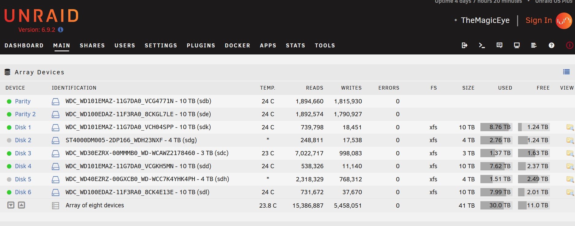

I've previously been told that when UnRaid does its periodic SMART data reads that this doesn't physically spin up the drives. I would really appreciate some clarification on this as it seems in my case that the drives do in fact spin up. You can see from the syslog pasted below and the attached screenshot of my array drive (taken at the same time), that the Colored Status Indicator is green. As per the tool tip this means the drives are active and spun up, or am I missing something here?

Sep 23 07:03:00 TheMagicEye emhttpd: read SMART /dev/sdj
Sep 23 07:07:21 TheMagicEye emhttpd: read SMART /dev/sde
Sep 23 07:07:21 TheMagicEye emhttpd: read SMART /dev/sdb
Sep 23 07:07:21 TheMagicEye emhttpd: read SMART /dev/sdc
Sep 23 07:07:25 TheMagicEye emhttpd: read SMART /dev/sdd
Sep 23 07:07:37 TheMagicEye emhttpd: read SMART /dev/sdl
Sep 23 07:07:51 TheMagicEye emhttpd: read SMART /dev/sdk
Sep 23 07:17:54 TheMagicEye emhttpd: read SMART /dev/sdg
Sep 23 07:18:05 TheMagicEye emhttpd: read SMART /dev/sdh
Sep 23 07:18:49 TheMagicEye emhttpd: spinning down /dev/sdj
Sep 23 07:22:55 TheMagicEye emhttpd: spinning down /dev/sdd
Sep 23 07:22:55 TheMagicEye emhttpd: spinning down /dev/sdl
Sep 23 07:22:56 TheMagicEye emhttpd: spinning down /dev/sdk
Sep 23 07:29:12 TheMagicEye emhttpd: spinning down /dev/sde
Sep 23 07:29:12 TheMagicEye emhttpd: spinning down /dev/sdb
themagiceye-diagnostics-20210923-0717.zip

I understand where you are coming from, it's just that as you can see with my logs, there is nothing else going on other than a spin up for a SMART data read. So doesn't that suggest in my case the number 1  is what is happening?
Either way I'd like to understand if this if common behavior that other users also observe. My concern is that constant spin ups for SMART data only puts a lot of unnecessary stress on the drives
Normal drive accesses like reads and writes aren't logged.
