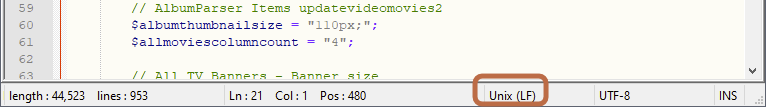

A big thank you for this! I managed to implement this and it works like a charm…. For me it’s a breakthrough that I have been wishing for a long time!
the script above did not work for me… my script contain the install command  line from Composer link in your first post. Then I added the command line in you first post.

Glad that I still posted it my solution as it was already over a month old :D
You might want to remove the hash check and roll with the downloaded installer, as you hard-coded the hash -of the current installer- in the script. If Composer ever got updated it won't match the hard-coded hash anymore and delete the installer. This is why I download the hash via wget and then compare it.
Interesting that the script I use now didn't work for you, but I only modified it mainly to check the hash as I am not sure how to 'exit' if the hash was incorrect via the php part, or well, I could've ignored the hash check anyway. 😛 Unless you forgot to use "composer require phpseclib/phpseclib:~2.0" as for me it installs into /bin as composer. I've updated my previous post adding the log file output, just for those that come after us to see the script in action.
Edited by Ocgineer
