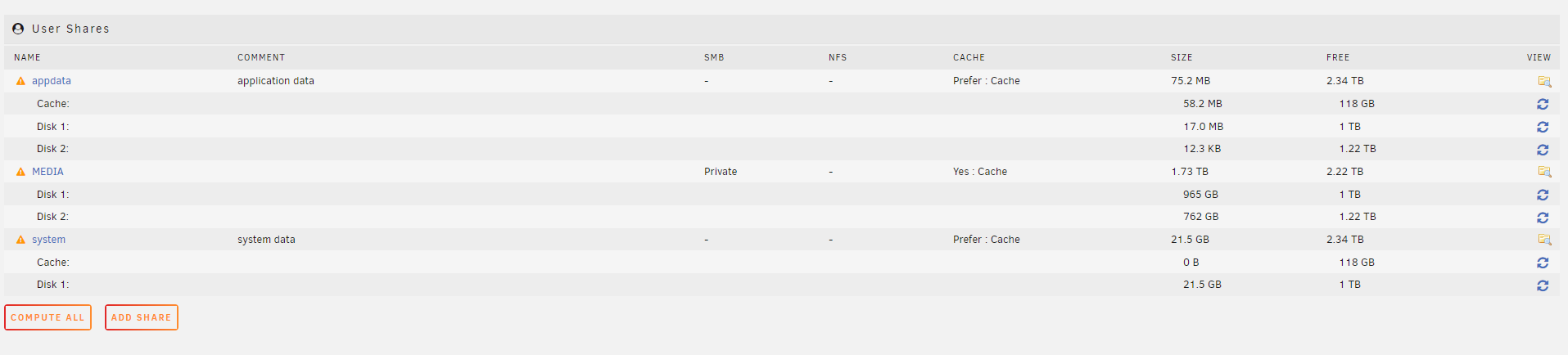

Go to User Shares, click Compute All, wait for the results, and post a screenshot.
yes I deleted the duplicate folder after sending the diagnostic ...
For the parity disk, it is dead. I have to order another one but I don't think that the problem comes from there.
I join the screenshot. I don't say why MEDIA is in private but that does not solve the problem :(
