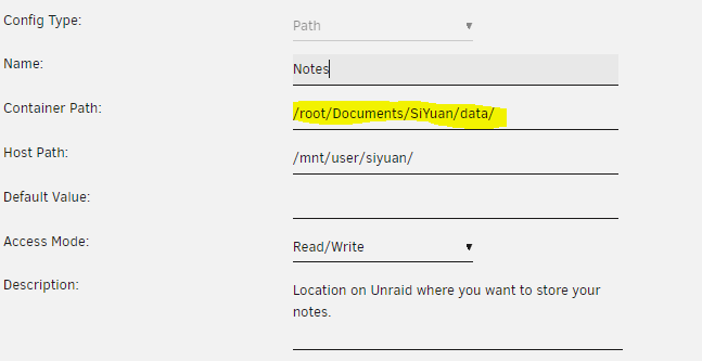

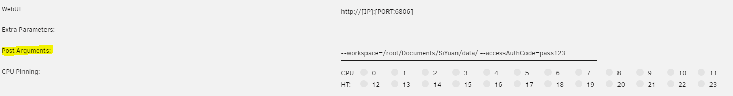

October 13, 20242 yr Hi, after a lot of struggles, I found out how to get the docker working on Unraid. You set your parameters, then switch to the advanced view. Take the Container Path from NOTES In the 'Post Arguments' field, add: --workspace=CONTAINER_NOTES_PATH --accessAuthCode=YOUR_WEBUI_PASSWORD in my case: --workspace=/root/Documents/SiYuan/data/ --accessAuthCode=pass123 Normally, you should have a working Siyuan.
November 18, 20241 yr On 10/13/2024 at 2:17 PM, Itsatsu said: Hi, after a lot of struggles, I found out how to get the docker working on Unraid. You set your parameters, then switch to the advanced view. Take the Container Path from NOTES In the 'Post Arguments' field, add: --workspace=CONTAINER_NOTES_PATH --accessAuthCode=YOUR_WEBUI_PASSWORD in my case: --workspace=/root/Documents/SiYuan/data/ --accessAuthCode=pass123 Normally, you should have a working Siyuan. You the best! works very well
May 19, 20251 yr On 10/13/2024 at 11:17 PM, Itsatsu said: Hi, after a lot of struggles, I found out how to get the docker working on Unraid. You set your parameters, then switch to the advanced view. Take the Container Path from NOTES In the 'Post Arguments' field, add: --workspace=CONTAINER_NOTES_PATH --accessAuthCode=YOUR_WEBUI_PASSWORD in my case: --workspace=/root/Documents/SiYuan/data/ --accessAuthCode=pass123 Normally, you should have a working Siyuan. Thank you so much! This was very annoying. This worked for me. They need to fix their default template.
