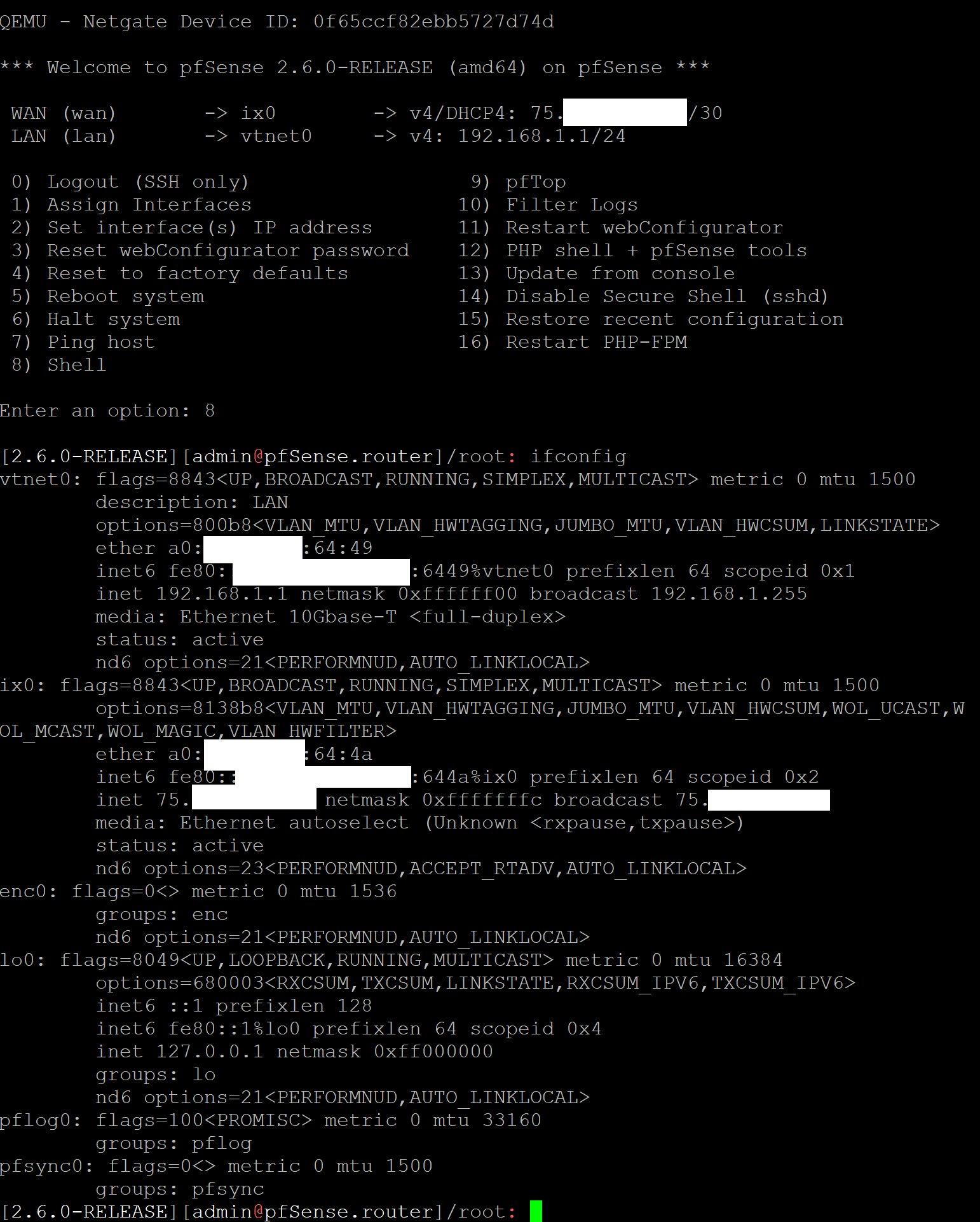

On 10/29/2021 at 4:54 AM, Ford Prefect said:
There is some guidance around here for how to passthrough a NIC and the setup of pfsense in a VM for unraid.
For the LAN port, the setting is quite simple.
With two NICs, when unraid starts, it will allocate both into a bridge and enable an active backup bond.
So the first task is to remove one NIC (for later WAN) from that...this will happen automagically, when you follow the instructions to passthrough the NIC. There the first step is, to exclude its IOMMU group from the use by the unraid host, so it can be allowed to passthrough for a VM. Mind you, that your Hardware - both CPU and Chipset - must be capable and configured in the BIOS to allow this. unraid will tell you in the system info, if IOMMU is enabled/available.
After that, now with only one NIC left / seen in the unraid host, you create the VM with one NIC (the other) from passthrough and a second one (which will be created in the VM template by default) as a virtio/virtio-net model.
Then assign WAN and LAN properly in the pfsense VM during startup. You will be able to distinguish these by the name/driver used. One one will be real, using the driver for your hardware NIC, the other will be virtual.
Outstanding post.  This is exactly the information I needed!

That router looks like it would fit the bill quite well actually.  There is only one lacking however that is the same shortcoming I am dealing with now.  My current router connects to my home network through 1Gb LAN to my Brocade switch.  The 2.5Gb LAN port on the router connects directly to unRAID via one of the 10Gb nics (10BASE-T).  unRaid's other 10Gb nic goes back to the Brocade switch so that the media server can feed the whole house at 10Gb.  The shortcoming is that there is no way to distribute the 2.5Gb WAN throughout the house as it goes directly to unRAID (does my family care...).
With pfSense on unRAID, I can use one 10Gb port for WAN and connect to the modem at 5Gb instead of just 2.5Gb because the modem has a 5Gb ethernet port (this would be cool because my connection is usually actually between 2800-3500Gb).  I can then use the other 10Gb port on unRAID to run back to my Brocade switch.  This would provide full +2.5Gb internet to be divvied up throughout the house via 1Gb pipes and also still provide 10Gb for media sharing.

For now as a stop gap, I think I will setup pfSense on unRAID and see what speeds I get and how well it works.  Obvious disadvantage is loss of internet if unRAID goes down, but I typically go months between reboots.  Advantage with unRAID would be potentially up to 3.8 Gb download speeds, not just 2.5 Gb.

This I find a little weird:
WAN showing "unknown" when it's connected to a 10GB port.  However, I tried to use ifconfig to set the WAN port to 2500baseTX and tried 5000baseTX and got error messages basically saying what I think means FreeBSD does not understand 2.5GB or 5GB:
[2.6.0-RELEASE][[email protected]]/root: ifconfig ix0
ix0: flags=8843<UP,BROADCAST,RUNNING,SIMPLEX,MULTICAST> metric 0 mtu 1500
        options=8138b8<VLAN_MTU,VLAN_HWTAGGING,JUMBO_MTU,VLAN_HWCSUM,WOL_UCAST,WOL_MCAST,WOL_MAGIC,VLAN_HWFILTER>
        ether a0:36:9f:20:64:4a
        inet6 fe80::xxxx:xxxx:xxxx:644a%ix0 prefixlen 64 scopeid 0x2
        inet 75.xxx.xxx.110 netmask 0xfffffffc broadcast 75.xxx.xxx.111
        media: Ethernet autoselect (Unknown <rxpause,txpause>)
        status: active
        nd6 options=23<PERFORMNUD,ACCEPT_RTADV,AUTO_LINKLOCAL>
[2.6.0-RELEASE][[email protected]]/root: ifconfig ix0 192.168.1.1 media 2500baseTX mediaopt full-duplex
ifconfig: unknown media subtype: 2500baseTX
I also tried 2500baseT, 5000baseTX, and and 5000baseT (not sure which is correct with new FreeBSD distributions).  Did I do this correctly?
Is there a way I can actually see the speed that may WAN port auto negotiated with my modem that you know of?  The modem has a 5GB port and that is it in bridge mode.  I think it's certainly connected at least at 2.5GB or I wouldn't have the speeds that I do at all, but I would like to verify what it is doing.
Edited by craigr

I like ethtool a lot better, but all FreeBSD seems to have is ifconfig instead.  I am not proficent in ifconfig as I am in ethtool.
"By second thought about your statement for the MAC of the virtio interface....it sounds like you did set the Mac manually? I don't think that this is useful/needed. Just make sure, that you attach the virtio nic to the unraid bridge br0, your LAN."
When I created the pfsense VM you can allow it to randomly choose a MAC or enter one manually.  I just chase the MAC I did because it's exactly in the middle of my two physical MAC addresses.  The both are identical XX:XX:XX:XX:64:48 and XX:XX:XX:XX:64:4A.  I figured XX:XX:XX:XX:64:49 would just be easy to remember is all.
This has been done in pfsense, I assume you mean also in my dockers?  Just for the heck of it, I tried setting nzbget to bro, bridge, and even host.  All perform the same.
I may give opnsense a try, but I would think my nic should be well supported by pfsense.  Both opnsense and pfsense run on FreeBSD so...
After hours when the family is asleep I'm going to try my ISP router again to make sure things aren't slow there too.
