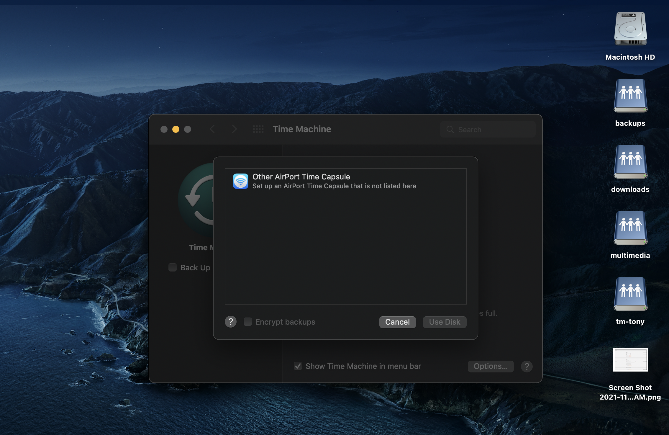

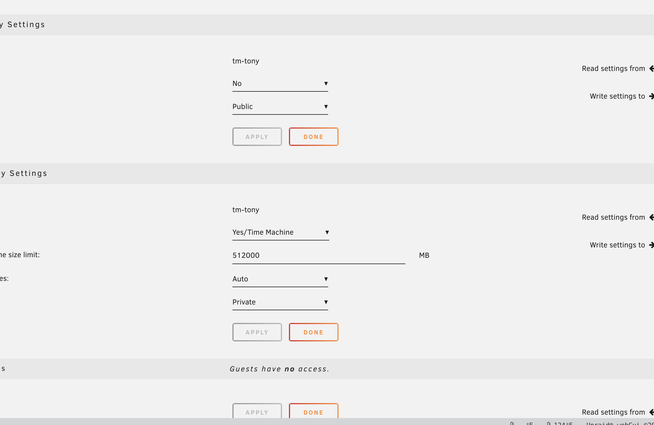

November 1, 20215 yr I got a new M1x macbook pro. I want to setup my Unraid server as a time machine target. I used the following guide I enabled Enhanced Mac OS interoperability, then I created a new share and created the tm share with the time machine capacity limit. When I connect to the SMB share then open the time machine app I see no offer to use the share as a time machine target... I tried to manually add it from the CLI and also no dice: flinte@Flintes-MBP ~ % sudo tmutil setdestination "/Volumes/tm-tony/" /Volumes/tm-tony: Disk does not support Time Machine backups. (error 45) The backup destination could not be set. Anyone out there using Unraid as a TM target with Mac os 12? Anyone have any thoughts on something I have missed in the config or maybe is this a regression/bug in Mac os 12? Edited November 1, 20215 yr by flinte
