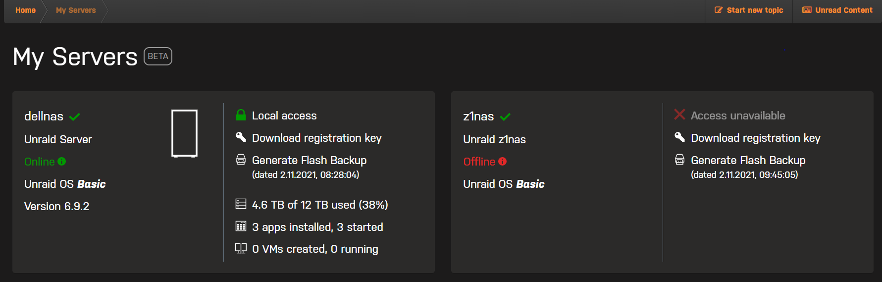

I have the issue that since the update to RC2 it seems the server does not connect correctly to the myservers service.
Tried deleting and reinstalling the plugin which did just delete the backups from local and remote but did not help with the dashboard showing "offline".

I've also the same issue with RC2 after the update. the stop -->delay 10 min --> start has not worked for me. Same with restart API.
If i restart the API sometimes i can see that the Error Message changes to "API Plugin Error" or something similar to "not connected to mothership" and never stop doing this. also the console connection which is integrated in the Dashboard is reconnecting again and again.

Update: after 20 minutes of waiting after the command "unraid-api start" the problem was fixed and works now.
