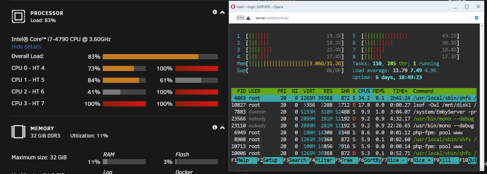

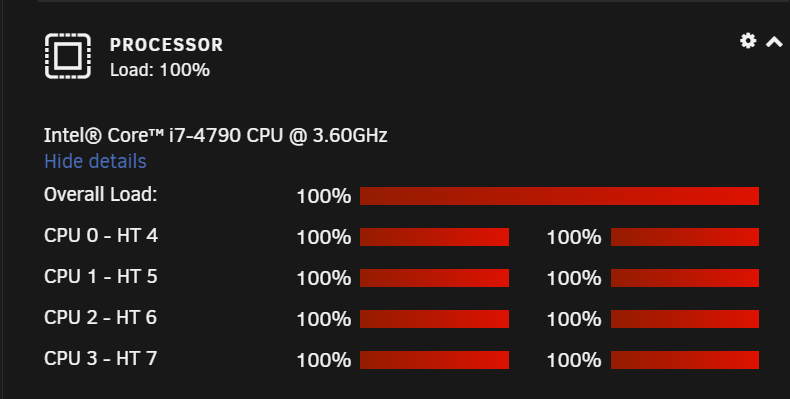

here's the situation: in Sonarr, when a new download of an entire season has complete, the Mover gets moving from cache to the array, then my CPU all maxed out making the server unresponsive. Even the Main tab takes a long time to refresh and any other tabs also. And, if I'm watching a video on Emby, it completely stops. Trying to refresh Emby page makes it spin and spin...
Once the Mover ends moving, everything comes back to normal

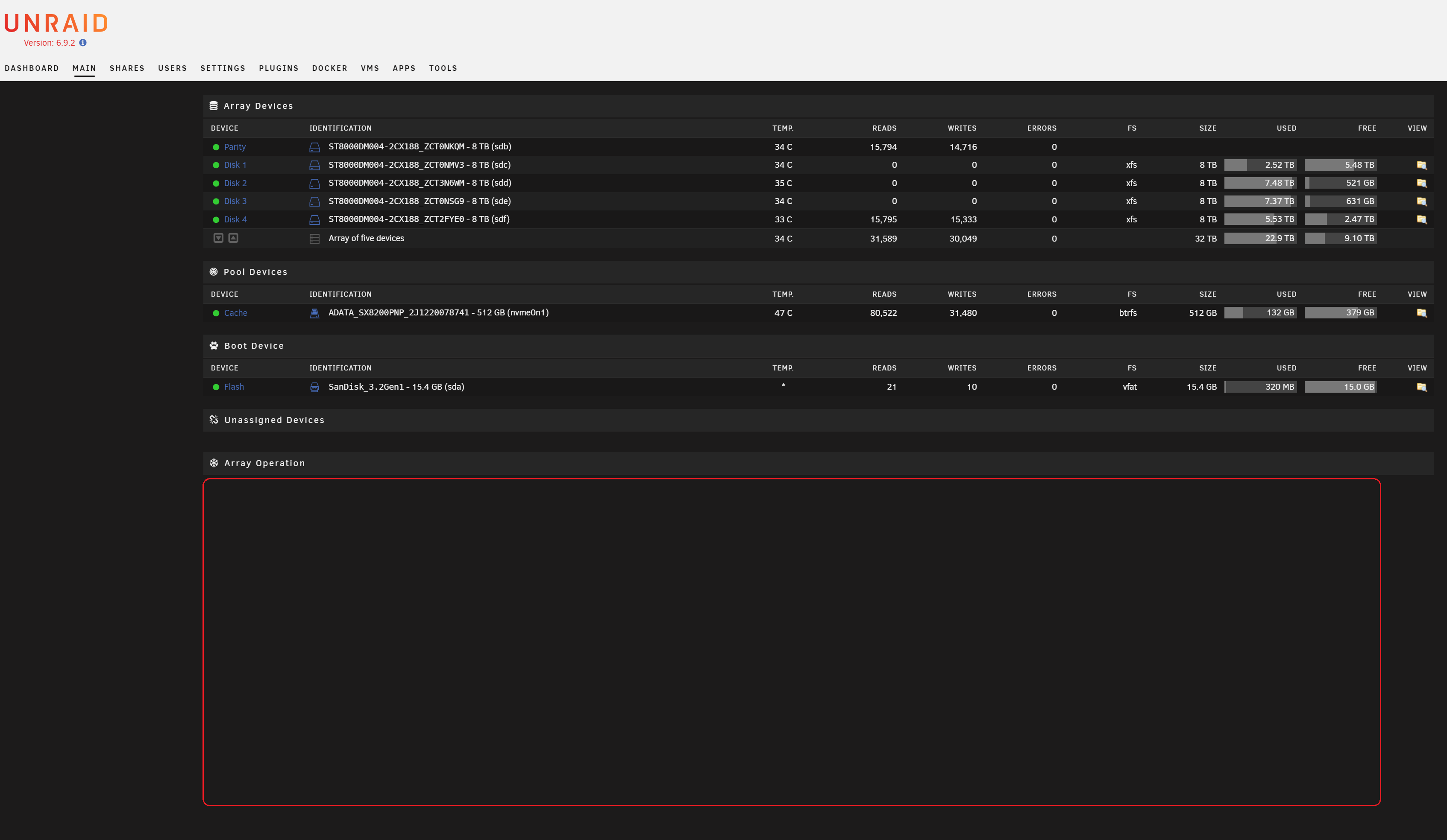

hitting refresh on the Main tab when the Mover is running
was wondering if the Mover was sucking all the life out of the CPU, and...

As top is not showing 100% cpu it could be iowait
ok, entire server is very unresponsive up to stop playing video file
