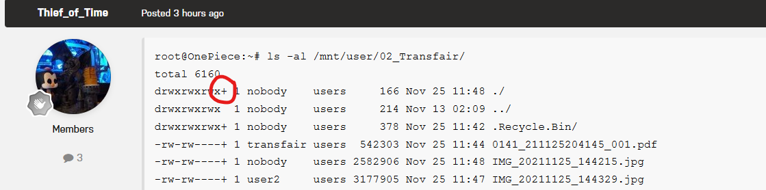

root@OnePiece:~# ls -al /mnt/user/02_Transfair/
total 6160
drwxrwxrwx+ 1 nobody    users     166 Nov 25 11:48 ./
drwxrwxrwx  1 nobody    users     214 Nov 13 02:09 ../
drwxrwxrwx+ 1 nobody    users     378 Nov 25 11:42 .Recycle.Bin/
-rw-rw----+ 1 transfair users  542303 Nov 25 11:44 0141_211125204145_001.pdf
-rw-rw----+ 1 nobody    users 2582906 Nov 25 11:48 IMG_20211125_144215.jpg
-rw-rw----+ 1 user2     users 3177905 Nov 25 11:47 IMG_20211125_144329.jpg
root@OnePiece:~#
The File "0141_211125204145_001.pdf" is created by my Printer(Scanner) with the Unraid Account "transfair"
The File "IMG_20211125_144329" is copyied from my Phone with my Unraid Account "user2"
The File "IMG_20211125_144215" is copyied from my Phone without any given any credentials/Account
From my PC I use the Unraid Account "user2" to Access the Files. The Access only works for the File "IMG_20211125_144329". The Share itself is "Public".
Notice the  "+" at the end of the permissions on the current directory.  This means that there are additional permissions assigned to this folder which 'fine-tune' the old Linux permissions.  (Observe that this "+" also appears on each on the files.

Hello,
thanks for the help. The "+" seems to be really the cause of the Problem. I set up a new Share with default permissions. I tryed to save some stuff from my Printer/Scanner and it worked perfectly. I went back to save the Files to the old share and it did not work.
Then i used following command:
root@OnePiece:~# setfacl -Rbn /mnt/user/02_Transfair/
That removed the "+" from that directory. After that was done I had no Problems saveing my scan files on that share again.
