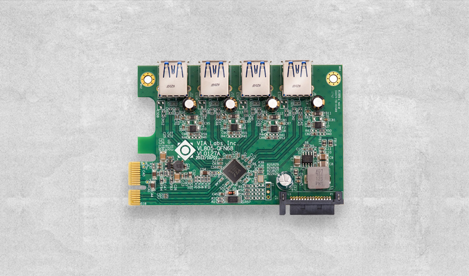

Have just installed an Orico 4-port USB 3.0 PCIe expansion card (https://www.orico.cc/us/product/detail/3330.html) into my HP Z800. It seems to be recognised by the hardware as it shows in the IOMMU groups, power is supplied to the USB drives, but they do not appear in Unraid UNassigned Devices. Plugging into onboard USB2.0 ports works however.
I am a bit of a noobie to unraid so am totally unsure what to do from here. This is the second USB3 card I have tried. This one specifically says that it is compatible with Linux.

03:00.0 USB controller: VIA Technologies, Inc. VL805/806 xHCI USB 3.0 Controller (rev 01) (prog-if 30 [XHCI])
        Subsystem: VIA Technologies, Inc. VL805 USB 3.0 Host Controller
        Flags: bus master, fast devsel, latency 0, IRQ 36, IOMMU group 18
        Memory at df000000 (64-bit, non-prefetchable) [size=4K]
        Capabilities: [80] Power Management version 3
        Capabilities: [90] MSI: Enable+ Count=1/4 Maskable- 64bit+
        Capabilities: [c4] Express Endpoint, MSI 00
        Capabilities: [100] Advanced Error Reporting
        Kernel driver in use: xhci_hcd
Have also attached the diagnostics package.

Seems to be showing in lsusb also. Bus 009 Device 002: ID 2109:3431 VIA Labs, Inc. Hub
But there are errors showing in the log.
Dec  2 16:29:59 XEUS kernel: usb 10-1: new SuperSpeed Gen 1 USB device number 12 using xhci_hcd
Dec  2 16:30:04 XEUS kernel: usb 10-1: device descriptor read/8, error -110
Dec  2 16:30:04 XEUS kernel: usb 10-1: new SuperSpeed Gen 1 USB device number 12 using xhci_hcd
Dec  2 16:30:10 XEUS kernel: usb 10-1: device descriptor read/8, error -110
Maybe related to power,  have you connected the SATA power connector the card if it has one like below?
Yes, I hadn't initially and there was no power to the USB HDDs. Connected and both drives spun up, but were still not recognised.
Any other thoughts?

Tried both a mouse & keyboard - No Luck. Logs attached.
cheers,
GT
xeus-diagnostics-20211207-1525.zip
Keyboard and mouse show in lsusb & in logs. Looks ok. What is not working with them?
Bus 009 Device 004: ID 045e:00db Microsoft Corp. Natural Ergonomic Keyboard 4000 V1.0
Bus 009 Device 003: ID 045e:009d Microsoft Corp. Wireless Optical Desktop 3.0
Bus 009 Device 001: ID 1d6b:0002 Linux Foundation 2.0 root hub
usb 9-1.1: new low-speed USB device number 3 using xhci_hcd
Dec  7 15:23:22 XEUS kernel: usb 2-6: new high-speed USB device number 4 using ehci-pci
Dec  7 15:23:22 XEUS kernel: input: Microsoft Microsoft Wireless Optical Desktop® 2.10 as /devices/pci0000:00/0000:00:01.0/0000:03:00.0/usb9/9-1/9-1.1/9-1.1:1.0/0003:045E:009D.0001/input/input4
Dec  7 15:23:22 XEUS kernel: microsoft 0003:045E:009D.0001: input,hidraw0: USB HID v1.11 Keyboard [Microsoft Microsoft Wireless Optical Desktop® 2.10] on usb-0000:03:00.0-1.1/input0
Dec  7 15:23:22 XEUS kernel: input: Microsoft Microsoft Wireless Optical Desktop® 2.10 as /devices/pci0000:00/0000:00:01.0/0000:03:00.0/usb9/9-1/9-1.1/9-1.1:1.1/0003:045E:009D.0002/input/input5
Dec  7 15:23:22 XEUS kernel: usb-storage 2-6:1.0: USB Mass Storage device detected
Dec  7 15:23:22 XEUS kernel: scsi host2: usb-storage 2-6:1.0
Dec  7 15:23:22 XEUS kernel: microsoft 0003:045E:009D.0002: input,hidraw1: USB HID v1.11 Mouse [Microsoft Microsoft Wireless Optical Desktop® 2.10] on usb-0000:03:00.0-1.1/input1
Dec  7 15:23:22 XEUS kernel: tsc: Refined TSC clocksource calibration: 2926.002 MHz
Dec  7 15:23:22 XEUS kernel: clocksource: tsc: mask: 0xffffffffffffffff max_cycles: 0x2a2d367e7b2, max_idle_ns: 440795351536 ns
Dec  7 15:23:22 XEUS kernel: clocksource: Switched to clocksource tsc
Dec  7 15:23:22 XEUS kernel: usb 9-1.3: new low-speed USB device number 4 using xhci_hcd
Dec  7 15:23:22 XEUS kernel: input: Microsoft Natural® Ergonomic Keyboard 4000 as /devices/pci0000:00/0000:00:01.0/0000:03:00.0/usb9/9-1/9-1.3/9-1.3:1.0/0003:045E:00DB.0003/input/input6
Dec  7 15:23:22 XEUS kernel: microsoft 0003:045E:00DB.0003: input,hidraw2: USB HID v1.11 Keyboard [Microsoft Natural® Ergonomic Keyboard 4000] on usb-0000:03:00.0-1.3/input0
Dec  7 15:23:22 XEUS kernel: input: Microsoft Natural® Ergonomic Keyboard 4000 as /devices/pci0000:00/0000:00:01.0/0000:03:00.0/usb9/9-1/9-1.3/9-1.3:1.1/0003:045E:00DB.0004/input/input7
Dec  7 15:23:22 XEUS kernel: microsoft 0003:045E:00DB.0004: input,hidraw3: USB HID v1.11 Device [Microsoft Natural® Ergonomic Keyboard 4000] on usb-0000:03:00.0-1.3/input1
