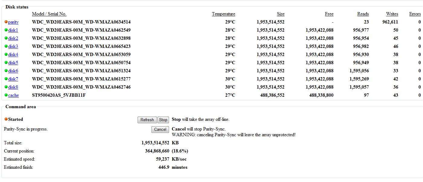

I thought the formatting message should go away after awhile.  It's many hours and it's still showing, the parity disk is still being written to but all the other drives are being read from.
It looks like your building parity. This will take many hours.

Here's the syslog Joe.  At this point all the drives are spun down (including the parity).  Yes, I add them all at once.  Until now I didn't see any reason not to.  I'm going to reboot and see what their status is.

I now know exactly what happened.  Simple mistake.  When you stick a bunch of drives in a new system and the parity drive is assigned then it starts doing a parity sync.  I needed to stop the sync before checking the format checkbox and clicking the format button.
You know it might just be a nice feature if it wouldn't allow the user to attempt to format while a sync is in progress.
I rebooted and started it up again but this time using what I like to call - the right way.  All good now.
As to Joe's question...no they weren't formatted.  Basically nothing happens to the data drives but the parity disk continues to be written to.

I don't think you needed to cancel the parity calc in order to press the format button and format the disks.  the two operations can occur at the same time.
I have formatted drives many times during a parity sync. Really no different than writing to the array. But I always give the parity sync a chance to get a few % into the build and verify the speed is reasonable before pressing format.
No, it caused the hang.  Stopping the sync I was able to format 6 drives at once.
