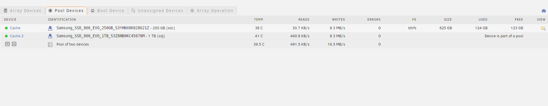

So I have a 1TB SSD and a 250GB SSD both installed in my unraid setup to be cache drives, but the combined size is 625GB for some reason.  Any one have any idea why?
Also, how would I removed the 250GB from the pool?
They are now 80% full, and I have the MOVR set to run hourly, and even though I manually ran it, nothing is changing.
default is btrfs raid1, which is a mirror, so the combined size would only be 250GB, raid0 would give 500
To get the total capacity for different size with no redundancy you need to use Single mode.
https://carfax.org.uk/btrfs-usage/
THANKS!  Good to know.
