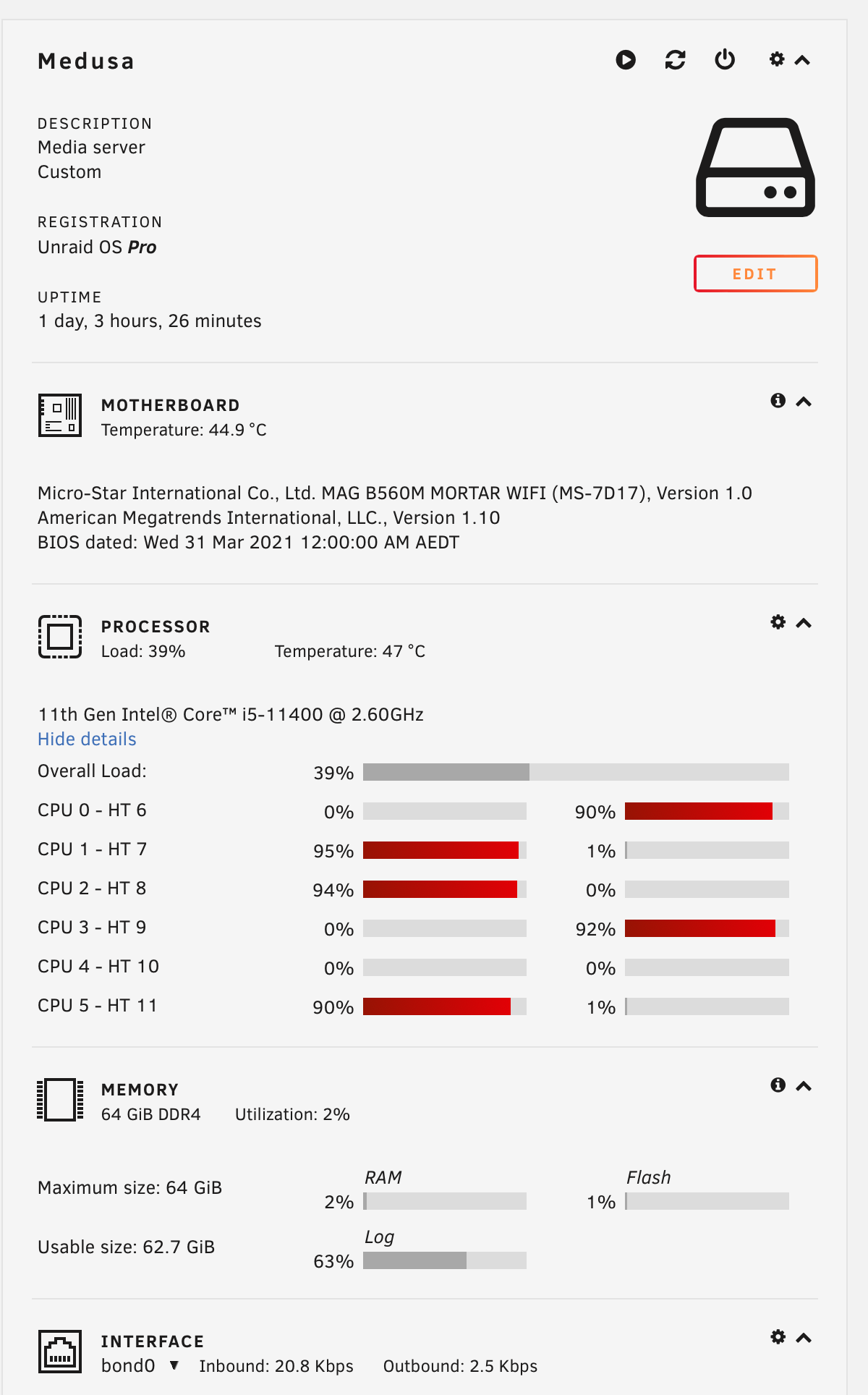

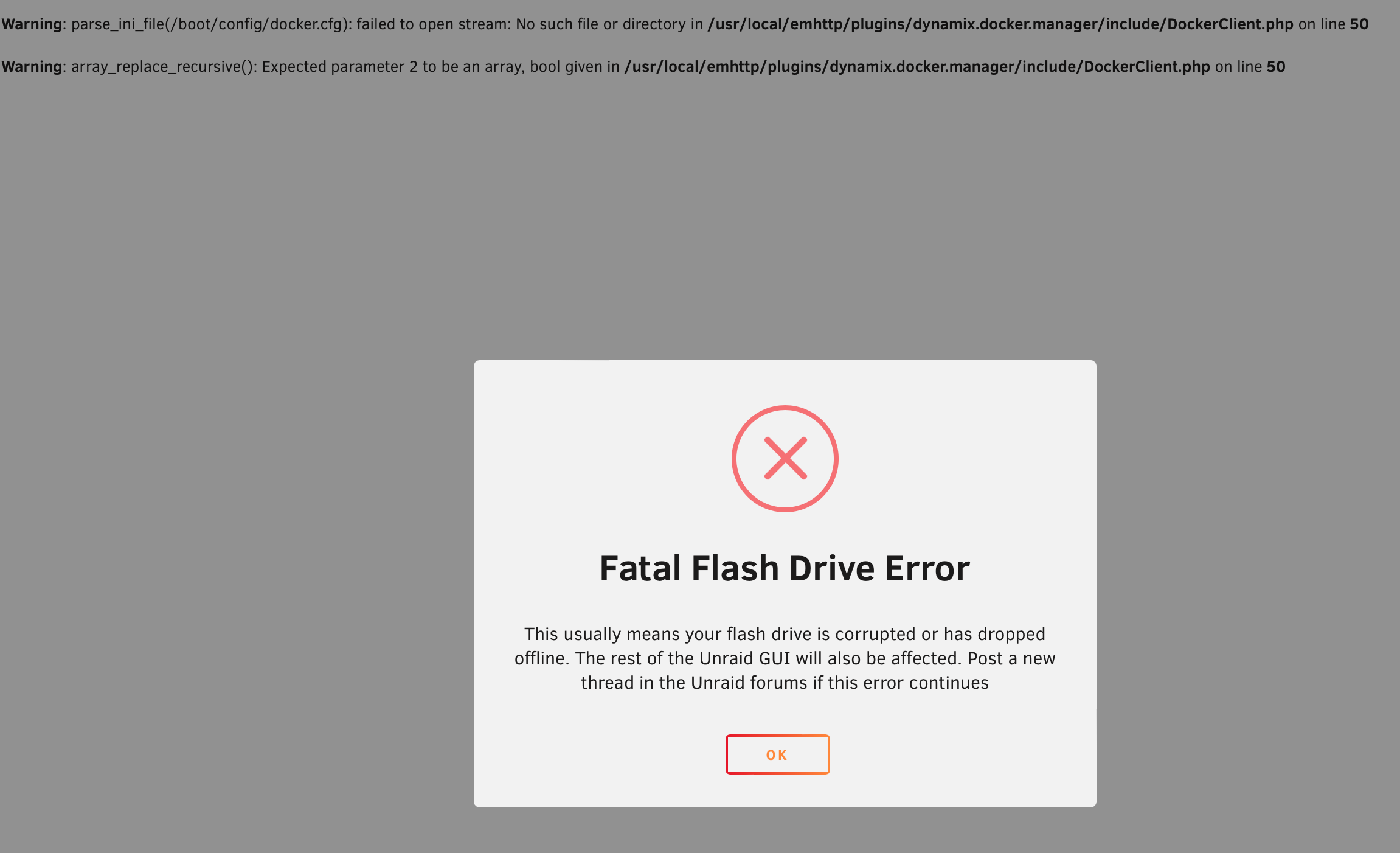

OK a bit of an update, seems something went horribly wrong, now the 2nd 12TB has also failed the pre-clear?
But now I also got a fatal error from the flash drive
1471067080_ScreenShot2021-12-19at7_59_17pm.thumb.png.c8558edb05d8c558c0c814078840b155.png1389980138_ScreenShot2021-12-19at8_00_31pm.thumb.png.394318b65dd423aa793fea7f50ce77e0.png
I can try another USB stick although this one is a USB 3 type, never had any issues in the HP while it was under test before moving to this new hardware,
Very strange!
Thoughts?

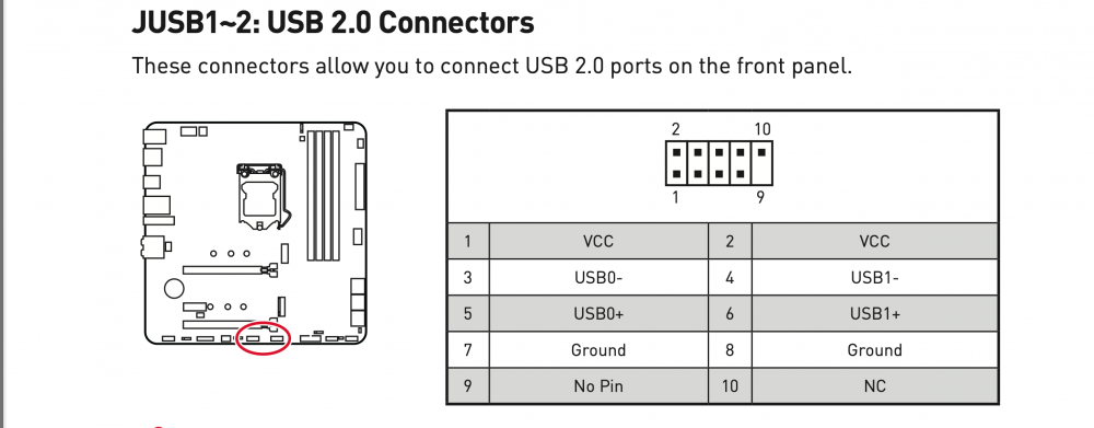

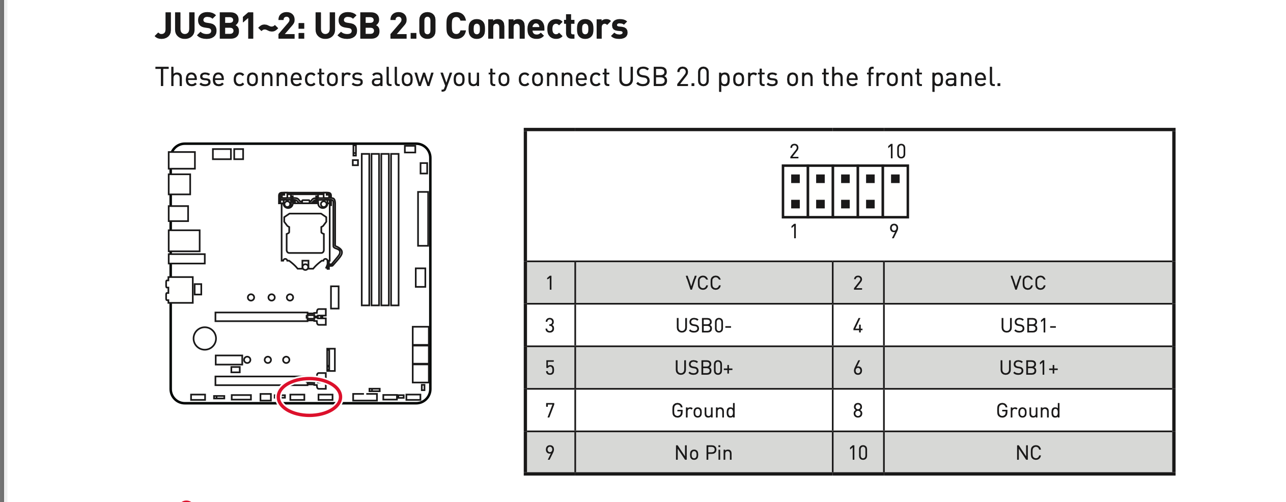

@Squid[2]FYI I'm using a USB2 port and I have a USB onboard connector which is USB2 as shown in the attachement [thanks for the tip] so we're going to lean towards the USB flash drive for having an issue?
  • So its in a USB2 using a USB3 Flash now the issue here or something else within my hardware?
