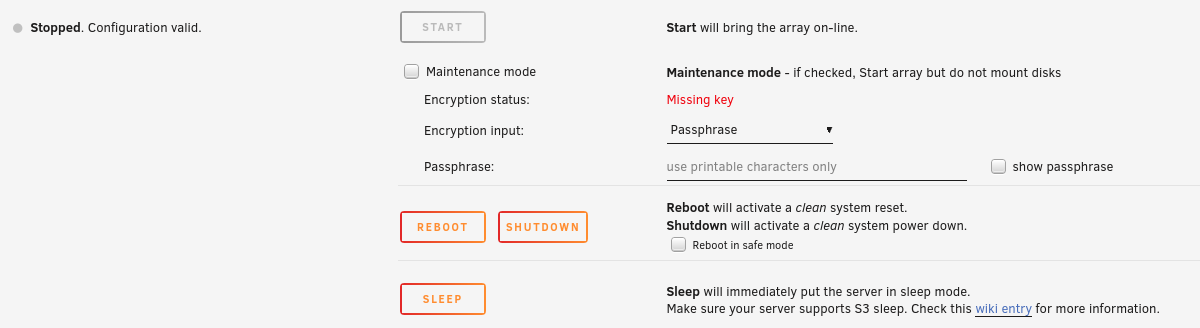

  7. So a new year and time to revisit my unraid server that has been shutdown for over a year due to forgetting my passkey PW for the array to startup. My original thread is HERE I tried to go back to a previous build but that had no affect on the PW and the array staying offline. Only option was to choose a format. The cache drive is since I forgot the PW was the only encryption drive as I had changed the format of the cache drive from XFS to ZFS so I could do snap shots. But something happened and it asked for my passphrase and I've been stuck since. Now 2025 I plan to just format the cache drive and start the array. I can see all my shares and folders are accessible with the exception of the docker and vm filesystems as these all resided on the cache drive which is now waiting to be formatted and the GUI shows it as FS:LURKS unmountable wrong filesystem. All apps and folders and addons are visible and accessible and while I had a backup it appears even the backup script was not doing what I thought it was doing - more on that later. My ASK Once I format the cache drive, I assume I will I need to reconfigure every docker container that I had and used from scratch even if the folders are on the designated drives? While Im at it, I plan on changing what the server is used for as in the past it ran jellyfin, but nowadays its just easier to stream from services anything I feel like watching and 1080p is fine for me and the family with no real demand for the hoards of movies I acquired over the years. I plan on adding a suitable apple Time Machine storage for multiple MACS and add home assistant and a few small dockers. Really need to good tool for photos on our apple phones too. Lancache is a must at my place too As for VM's, I may try my hand at running an arcade emulation and see if I can make use of the 2080 GPU sitting in the server doing nothing like a Minecraft server or a CS:GO for the kids play, not really sure what sort of grunt I will need to make that work.. Now for my backup script I tried to use the option for when I inserted a UBD drive to back up the files of selected folders and directories and used this thread HERE I am not sure what went wrong as my external HDD 20TB HDD has all the shares backed up and can be access all files except the backup of the cache drive as all files show 0 bytes which I assume is possibly due to it being ZFS and or encrypted or both? Not sure as I also had a backup of my unraid USB stick too and that also is 0 bytes..meh! Next ASK ZFS, I do like the idea of snapshots, do I reformat all drives as single raid 1 ZFS drives just to have this feature, what are people doing as my NAS is simple all the same drives 12TB x 4 with 1 parity and 1 cache Im running 7.0.0 and ready to format, I usually base my configurations and builds using ibracorp and space invader tutorials
  8. OK, thanks guys, I am going to attempt to downgrade and see what happens as either way I am locked out due to making the passphrase in the first place, should've stuck with dumbo 123! Only encryption done is the cache drive, no other drive and that I changed the cache drive from XFS to ZFS Will be a good test, but when I get a chance to turn it on, I am going to give this a try as potentially only the cache drive will need reformatting

  12. So I had a power outage and server rebooted only to find the array stopped due to missing key. I do not recall the passphrase I used sometime back when I converted my cache drive to zfs when 6.12.4 was released Am I shit out of luck to reset the key? Being the cache drive is the only zfs formate file system is there a simple recovery method? The permit reformat - will that destroy all the content of the 4 x 12TB & Parity drives? I do have a backup to an external 20TB drive mainly the folders that I wanted to backup, not sure if it included dockers or the USB drive on that backup. If I remove the cache from the array & format it will it bring me back to the same place with a missing key or is the encryption across the whole array? Only the cache drive is formatted as ZFS and for some reason I'd chosen encryption just not sure if its only on this cache drive and I can get the array started again? What Options are available for stupidity?
