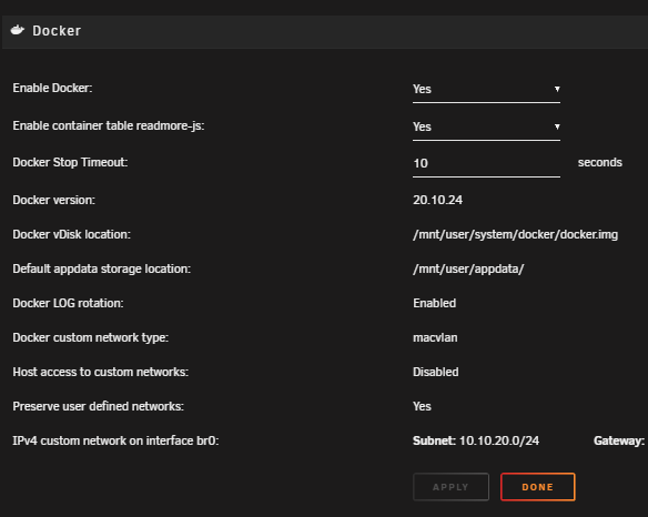

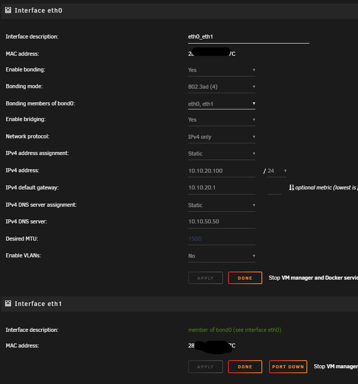

Can I get some clarification around moving from macvlan to ipvlan?
I have upgraded my backup server and made the change to ipvlan with bridging still enabled. nothing seeing any issues but it is a backup with no VMs and only two dockers running not using a custom network
concerned about primary server that is still using macvlan, bridging enabled, host access to custom networks : disabled, ~30 docker containers (10 are using a custom network) and several VMs (some use their own ports on a 4 port nic -Blue Iris for example which is also on a separate vlan)
What exactly do I need to change when converting to ipvlan?  Does bridging need to be on or off? host access to custom networks?

Is this update gonna make some problems for me when I'm running like this?
I do have ab firewall that don't like when I use IPVLAN... when you have over 30 containers and all of the came up with same MAC address with different IP, I had problems to access my containers. That's why I use MACVLAN. Never hade any CALL TRACES error before.
Almost all my containers are using br0 network.
Edited by CiscoCoreX
Settings > Docker > Host access to custom networks = Enabled
But thats not needed for the macvtap solution, right? Its just needed in case Host <-> containers want to talk, like ususal?

Quick question, if we want to follow the following steps do we do them BEFORE updating to 6.12.4 or AFTER updating?
"For those users, we have a new method that reworks networking to avoid this. Tweak a few settings and your Docker containers, VMs, and WireGuard tunnels should automatically adjust to use them:
Settings > Network Settings > eth0 > Enable Bridging = No
Settings > Docker > Host access to custom networks = Enabled"

About to update from 6.12.3 using the ipvlan work around as I was getting crashes.  I'm also using ubiquity UDMP and a 48 port switch so I'm wondering if there is anything I specifically need to do other then what's in the update notes?
Also would the 6.12.3 setup cause issues when trying to enable aggregation through my switch since my dell r730xd and the network card should support it?  Because every time I tried my system would not like it.  And if so would this update help fix that?
Thanks guys.
