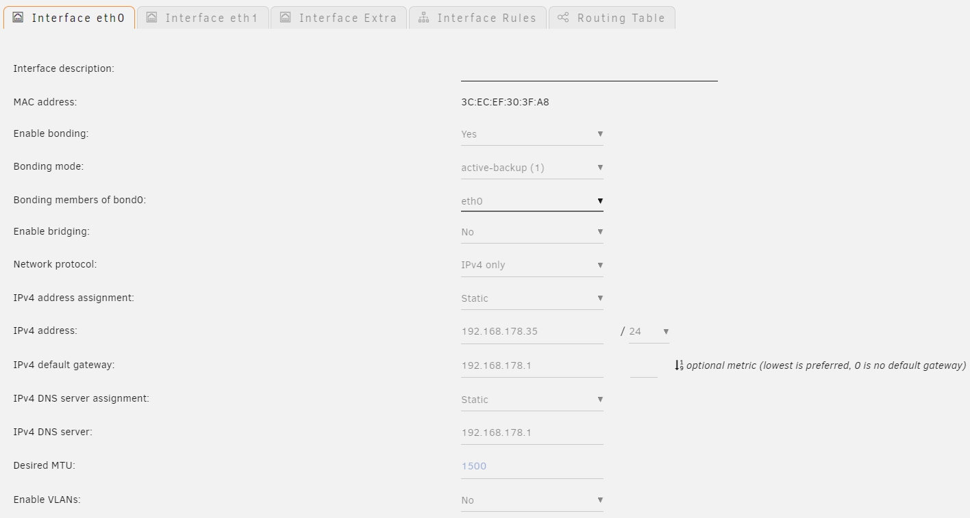

Hey guys, i just updated to 6.12.4 and was previously using ipvlan after some call traces with macvlan. I also have a bunch of dockers with custom: br0 network, so bridging was enabled.
I updated now and disabled brdiging as per the release notes and started docker, but now my dockers wont start anymore. I have also read, that this can happen and i simply have to change to "custom: eth0", but that network does not exist. So i am unable to start my dockers now. What am i supposed to do? I want to switch back from ipvlan, because i had some issues with it, which is also documented in the release notes
I will add the GUI/scripts do not present the bond0/eth0 custom option it seems under some circumstances...for me, it was due to the presence of my custom ipvlan network.  That is expected behavior, but upon deleteion of the custom network, they should show with all the network/docker settings set appropriately.  They however do not.  I'm investigating...

Ok guys, something aint right. I re-enabled bridging, but no luck. br0 is gone aswell now. Then i rolled back to 6.12.3 and i cant get br0 now there aswell
Something bricked now, i have no idea what is going on
Edit: It was ipv6 all along. I have no idea what happened, but the update borked my docker ipv6 settings and made unraid/docker unable to create any custom network interface

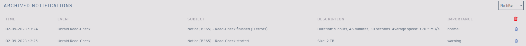

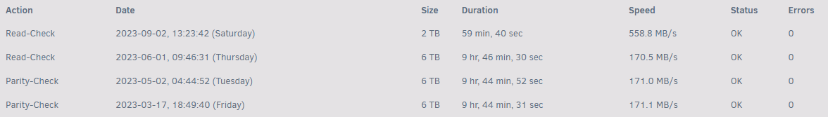

Minor bug on 6.12.4 ? I perform read check ( no parity ) on array, it report duration 9hr+ but actually finish within an hour.
Edited by Vr2Io
Did you create a bug report in stable section?

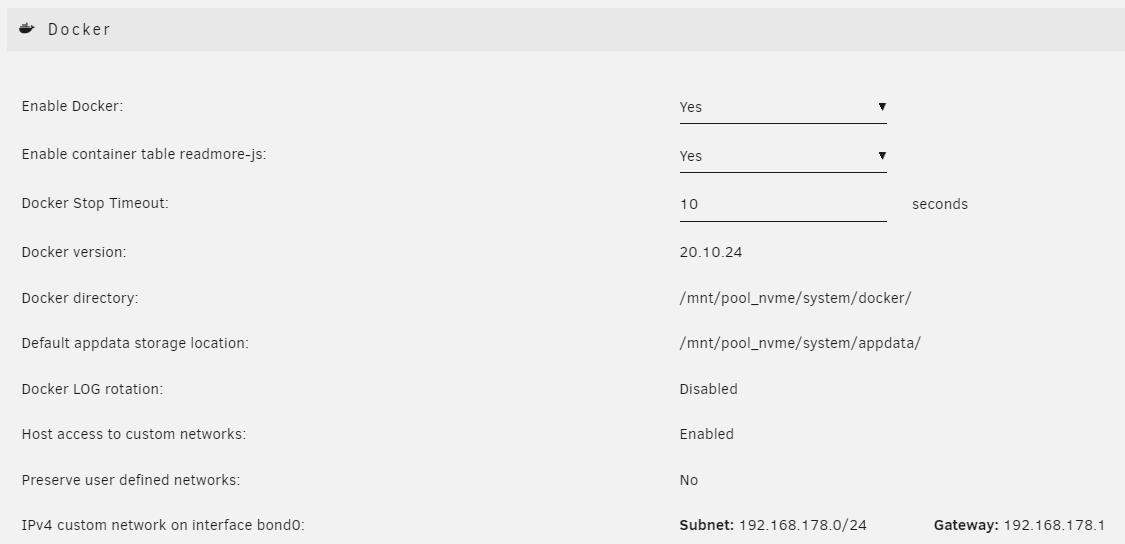

After upgrade from 6.11.5 to 6.12.4 where can I see that everything is configured correct? I don't see IPVLAN, MACVLAN or MACVTAB anywhere within the settings:
CLI shows that - but shouldn't there be MACVTAB somewhere?
root@Tower:~# docker network ls
NETWORK ID     NAME      DRIVER    SCOPE
8adcdd141eb5   bond0     macvlan   local
d0d7de380f93   bridge    bridge    local
bf554ebaaab7   host      host      local
68626f6bf303   none      null      local
Thanks in advance.
