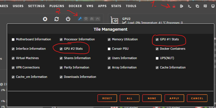

Updated today and I noticed that GPU Stats plugin use to detect my Arc A750 on 6.12.3, however on 6.12.4 it can only detect my Intel iGPU.
Make sure you have booth GPU selected in the GPU Statistics.
In the Dashboard:

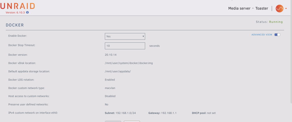

Been away from Unraid for quite a while and am still way back on 6.10.3.
Is there anything in particular I need to pay attention to with this update?I did see there was mention of Fritzboxes and Ubiquiti equipment, both of which I run.
Thanks!
Thanks!
Run Tools > Update Assistant first then follow release notes upgrade procedure:
