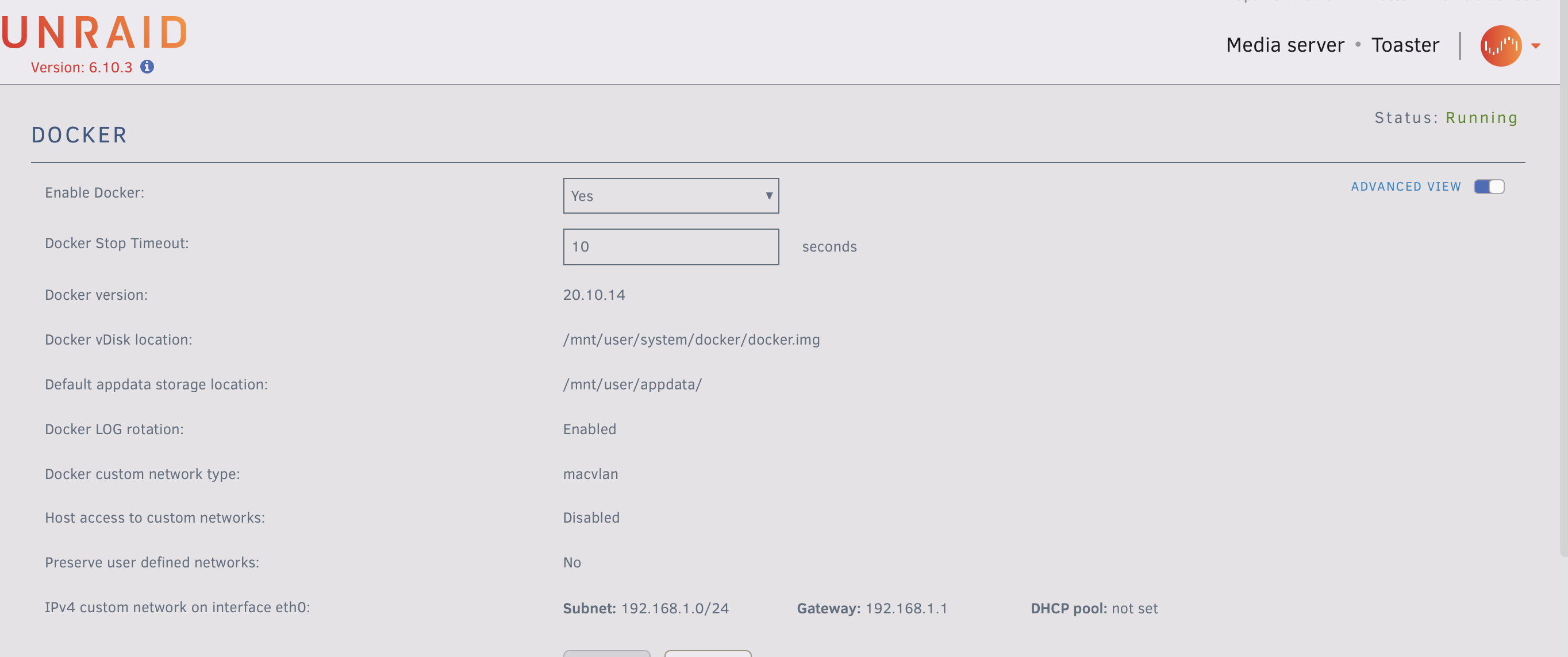

Thanks for this. I'm not sure what my setup is running, I guess macvlan:
2037419677_Screenshot2023-10-18at21_49_30.thumb.png.f5bf0b353713db036e4a6880e8bd225f.png
I really don't understand what any of this means though TBH. In the past I've updated unraid and it's usually worked fine.

  • Correct me if I'm wrong anyone, but as I understand it you can still use macvlan, but instead of br0 it will now be eth0 and everything should work as before. That's what I read when I skimmed through

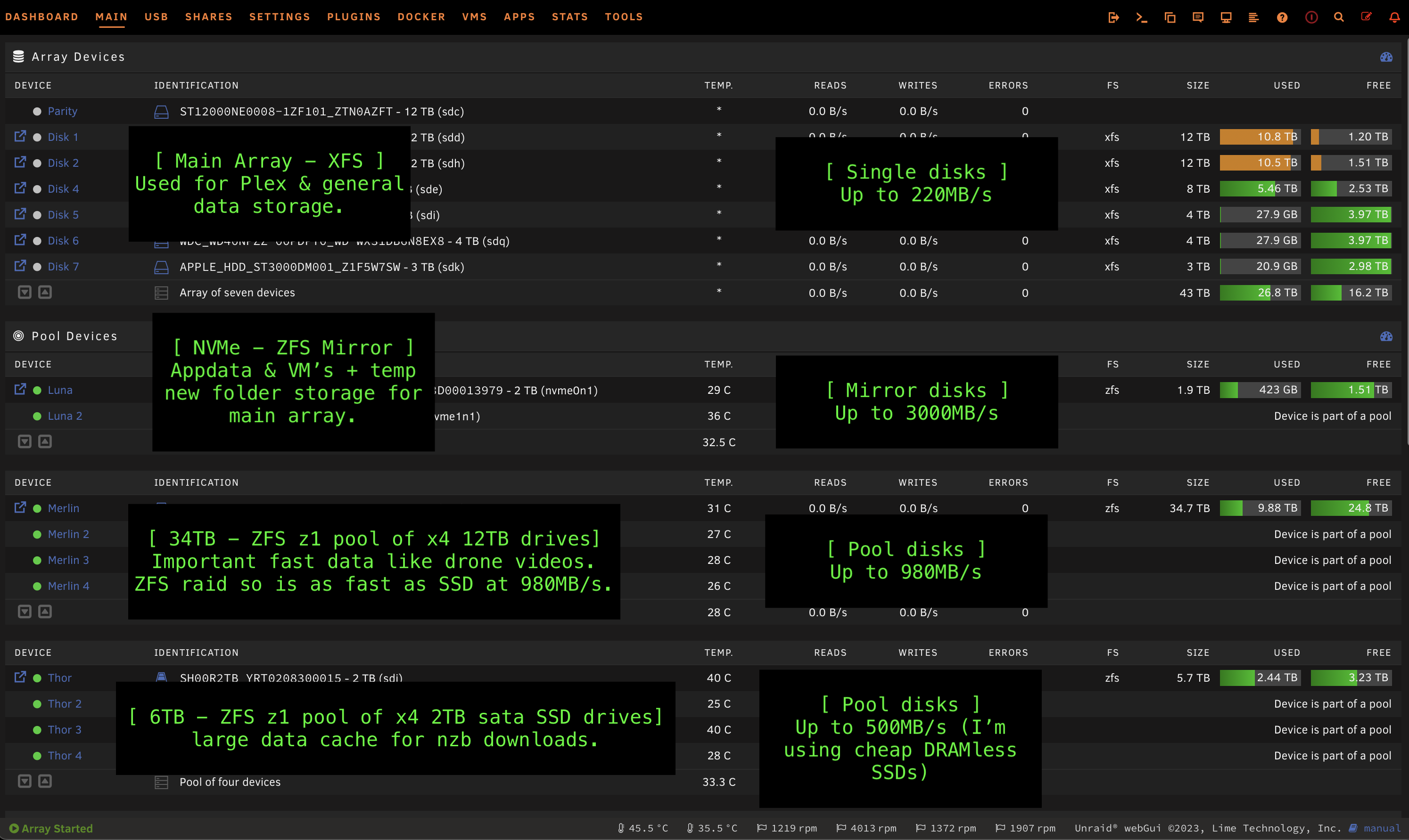

I just wanted to check if the next big version update might allow multiple unraid arrays?
Just because I would like to separate some slower drives out.
Older drives top out around 100MB/s whereas my newer drives can do 220MB/s.
Would rather not have more than 16x drives in the main array due to the slowness of parity checks.
I know there is a plan for pool to pool moving.
35675167_Screenshot2023-10-25at00_38_16.thumb.png.6e365ff6929cb22435d6b26d47236aec.png
Edited by dopeytree
That is expected yes.
Note that the number of drives does not affect the speed of parity checks.   The length of time a parity check takes is primarily determined by the size of the largest parity drive.

I think the multiple arrays support may have slipped to the 6.14 release with the 6.13 release concentrating on improving ZFS support.   I could be wrong about that though.
Well yes, and no.
While obviously the size of the largest drive in the array (and by design, the Parity drive) is a major factor, having smaller, slower drives mixed in can also play a significant role in how fast the overall parity check/rebuild takes.  Assuming, of course, that other drive activity isn't interfering with the drives 'syncing up' their access cycles to maximize the parity check speed.
All spinning drives start off the check at their fastest speed, and end at their slowest speed at the top end of their capacity.  As parity checks will run only as fast as the slowest drive, having mixed sizes in your array will increase the overall time it takes to run a parity check.
Let's look at this example:  10 drives + 1 parity in the array - a 16TB parity drive, 9 16TB data drives, 1 8TB data drive.  All drives have a linear access speed curve - 250 MB/s at the first sector, 150 MB/s at the last sector.
Once you start the parity check (and give the drives a little time to sync up) you are moving right along around 250 MB/s.  The 8 TB drive starts slowing down faster than the others.  4TB along, you are now down to 200 MB/S, at 7.9TB you are at 150 MB/s.
Once you clear the 8TB done point, the speeds will increase from 150 MB/s to 200 MB/s, then ramp down to 150MB/s for the rest of the check, but at a rate that is half as slow as the first 8TB slowed down.
This is exactly what I saw when I recently replaced the remaining 8TB drives in my array with those which matched the 16TB drives.  My average speed jumped up to 186 MB/s from 166 MB/s.
Edited by ConnerVT
speeling
At the fine detail level you are correct when you have drives with a lot of different sizes.   If however you are adding additional drives that correspond to a size you already have then they will almost certainly not affect the overall time.
