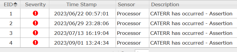

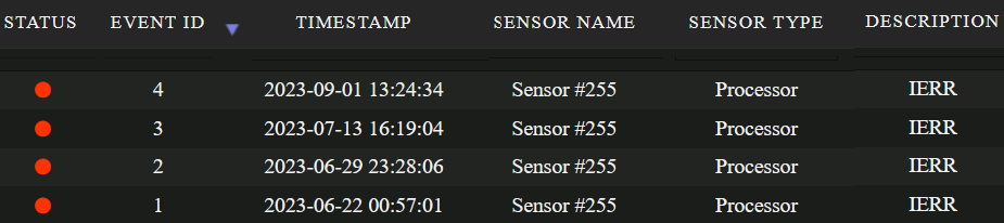

Upgraded from 6.12.3 to 6.12.4 and it went mostly smoothly as everything is running fine and well now.
However, I followed the instructions and did shutdown the array before upgrading.  Upon reboot, unRAID briefly came online (web GUI and all) and then completely crashed.  This has happened upgrading to 6.12.0, 6.12.1, 6.12.2, 6.12.4; but NOT 6.12.3.  My IPMI records show this for each of the upgrades.  This is the ONLY time my machine has EVER crashed; only after the FIRST reboot after the four upgrades I have mentioned.  I have had this configuration since 2019 with very few changes.
Supermicro IPMI:
unRAID IPMI plugin:
Above are my IPMI errors, one for each upgrade 😬.  When it crashes there is no cursor blinking at the terminal on the monitor connected to the machine, no ssh, no web GUI, but the IPMI fan control seems to be running as the fans are not at full speed.  I have to do a hard shutdown with the power button, and then of course a parity check starts on the next reboot which I always cancel because there will be no errors.
Also, after this update, for some reason my Deluge docker would not start.  I forced an update and it started fine after that.
I really don't like these crashes after moving to 6.12.x on my system.
Thanks for the update and kind regards,
craigr
That is confusing. There are a few things I would try if it were my system:
1) Check the bios for anything related to "fast boot" and disable it
2) Avoid rebooting. Instead, do a shutdown to power the system off fully and then start it back up.
3) Go to Settings -> Disk Settings and set "Enable Auto Start" to "no". This will ensure that if it crashes while booting, the array will not be affected. Of course, it also means you will have to manually start the array using the webgui once the system comes up.
Thank you for these ideas.  I like them all, though I think 2 & 3 have the most likelihood of providing some help.  After no crash upgrading to 6.12.3 I didn't worry, but next time I will be sure to write the log to flash as well and hopefully glean some information from that.
Thanks for your help and again kind regards,
craigr
It's impossible to get log data now, because it won't crash again (based on prior experience).  It only happens on the first boot after the upgrade.
