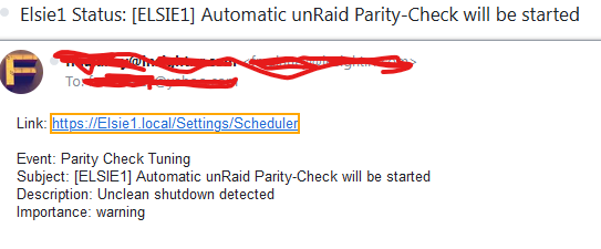

I upgraded this morning and got this message after I rebooted:
Before I upgrading, I stopped all of the Dockers and stopped the array.  I then started the upgrade.  After seeing that I had this message (Within ten minutes after the server came back.  I checked on MAIN and there was no Parity Check running.  I spun all the disks down and they stayed spun down.  I am attaching the Diagnostics file.
elsie1-diagnostics-20230904-1228.zip
You can ignore that message as the plugin can generate it spuriously.    This is being worked on.

That message got introduced when the option to restart array operations was added as the plugin can only restart operations if it was a clean shutdown.  It is meant to be an informative message only and does not actually cause anything to happen.
I am currently working on some issues around the restart logic so this should get fixed as a by-product off that.    I could remove the notification entirely from the code so would welcome some feedback on whether it is useful (assuming it is working correctly).  My feeling was that it helped users by them not having to visit the syslog to be certain what had happened.
9 minutes ago, AgentXXL said:
I tried manually deleting the file /config/forcesync but I still got the notification on the next array start. I'll wait to see if an upcoming update to the parity check tuning plugin fixes it. Worst case is I wait until my next scheduled parity check and see if that clears it up.
I have reproduced this in a test environment so I am virtually certain that the next update will only output this notification if it really is an unclean shutdown.
Do you think this message adds value (when it is working correctly) as I could simply remove it from the plugin code.  My thought was that it was useful to users to know this had happened without them having to look into the syslog.

My question to your question is, "What exactly is the message intended to be conveyed to the recipient if it was working properly"?  It is not clear to me if the message was intended to be sent if (1) there was an unclean shutdown or (2) that the Parity Check Tuning plugin was running and would start the next regularly scheduled parity check using the Parity Check Tuning plugin.
Edited by Frank1940
Added "parity check"
5 minutes ago, Frank1940 said:
My question to your question is, "What exactly is the message intended to be conveyed to the recipient if it was working properly"?  It is not clear to me if the message was intended to be sent if (1) there was an unclean shutdown or (2) that the Parity Check Tuning plugin was running and would start the next regularly scheduled using the Parity Check Tuning plugin.
It is simply meant to inform the user there was an unclean shutdown - case (1)  The plugin does not initiate anything as a result but Unraid normally does.  It would, however, not restart any array operation that was in progress during the shutdown phase (from point then reached).    Note the plugin never initiates a parity check or other array operation from the beginning - that is always done at the Unraid level.     Maybe I should change the wording and not mention Unraid automatically starting an array operation?
If the message (that I received is an error in logic in the sub-routine is the reason I got it, the message is fine.  The thing thatcaused me confusion is this one:
If this were changed to:   Event: Parity Check Required
Then it would be clearer what was happening.  Obviously, the logic that sends out the message has to be fixed so that it is not sent out when a clean shutdown are actually the case!
Further thoughts on this:  If the fact that this message is required by Developer Plugin Conventions, then change this line:
    Subject: [ELSIE1] Automatic unRaid Parity-Check will be started by Parity Check Tuning plugin
There is no REQUIREMENT to output a message at all :)  The plugin has to determine if there has been an unclean shutdown for its own purposes as that means it cannot restart an array operation that was already in progress at the time of the shutdown.  Since the plugin has detected the unclean shutdown it seemed a good idea to pass this information on to the end user even when a restart was not potentially going to be attempted.
I want the event field to identify what has generated the notification (as is the case elsewhere).
It is the Subject and/or Description fields that can be changed.   However your suggested wording would be inaccurate as It is NOT the plugin that starts the automatic check it is the core Unraid system.
