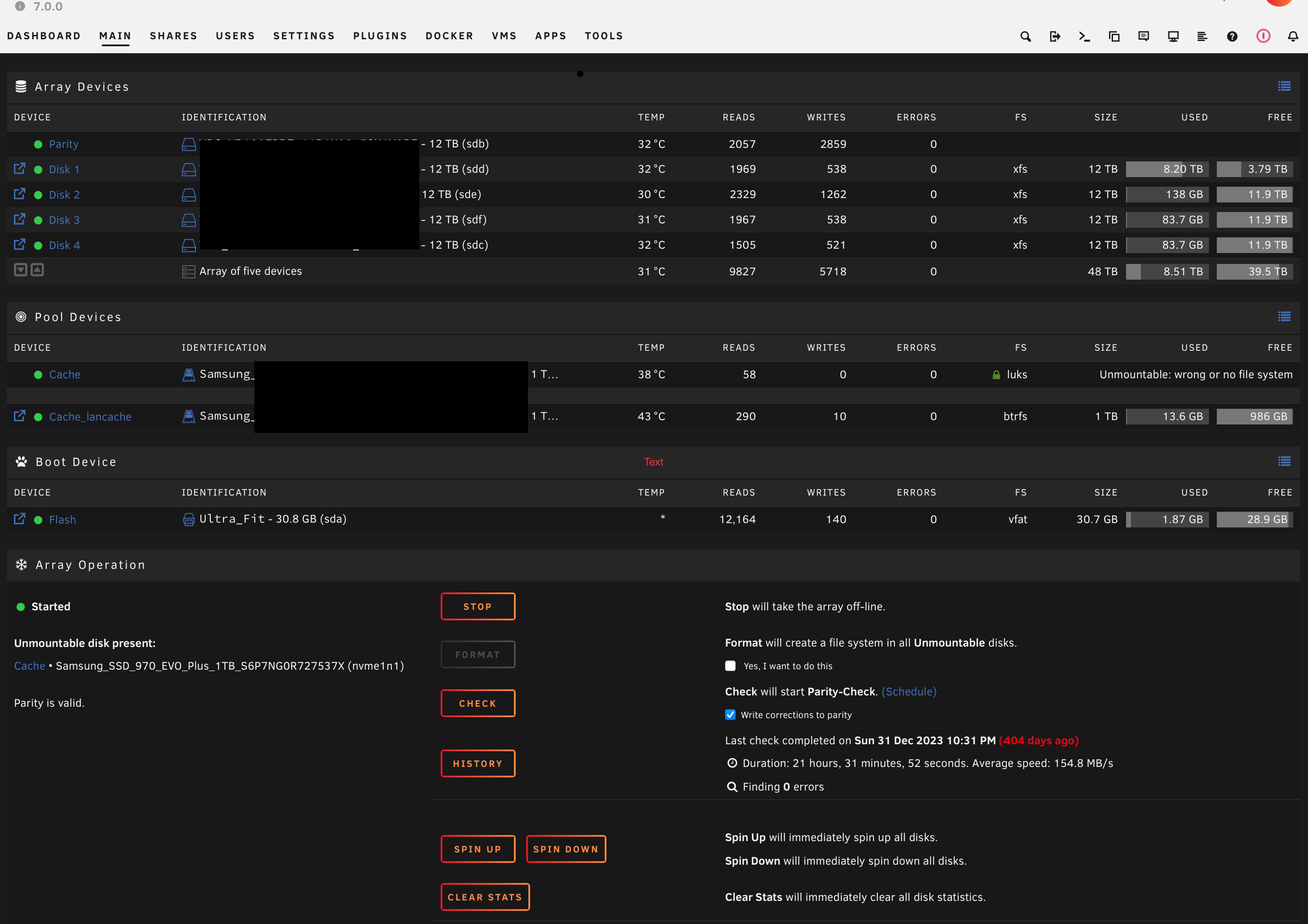

Ok I have tried to format the cache drive and it still shows up as LURKS FS and unmountable
Is this because this was zfs encrypted?
/dev/nvme1n1p1: UUID="xxxxxxxx-xxxx-xxxx-xxxx-fxxxxxx" TYPE="crypto_LUKS
Do I need to run some sort of disc rescue?Screenshot2025-02-09at8_41_05pm.thumb.png.52c075deb369e601f006f893ea7b28c8.png

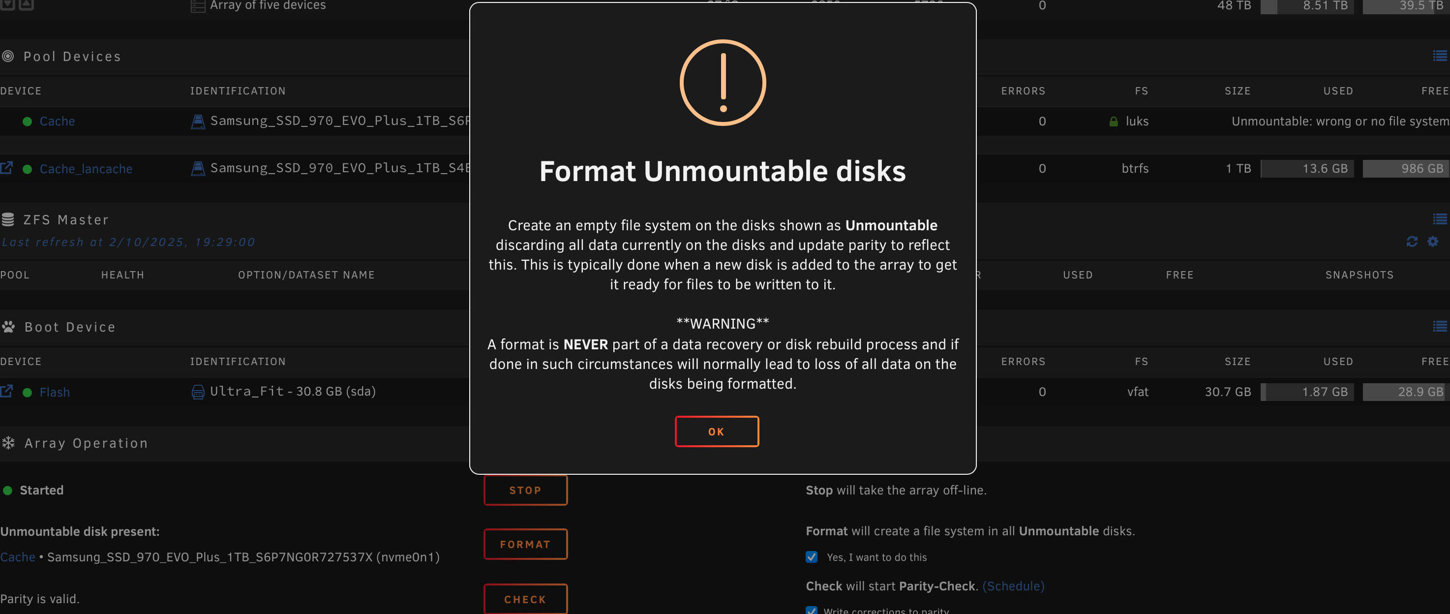

Just to clarify I do not need to recover I just need to format in order to start again since I have forgotten my passphrase, so not sure if this has any relevance to the procedure, but will boot up the server and find UFS explorer
Can I confirm if I should format the cache drive while in unraid GUI or outside unraid?
Edited by Kosti
added picture
Never mind, Im an idiot!!! I simply booted up, removed from pool, added it back, picked btrfs and not zfs encryption this time and formatted again once I restarted the array. Now I noticed where there passphrase comes in, by choosing zfs encryption
