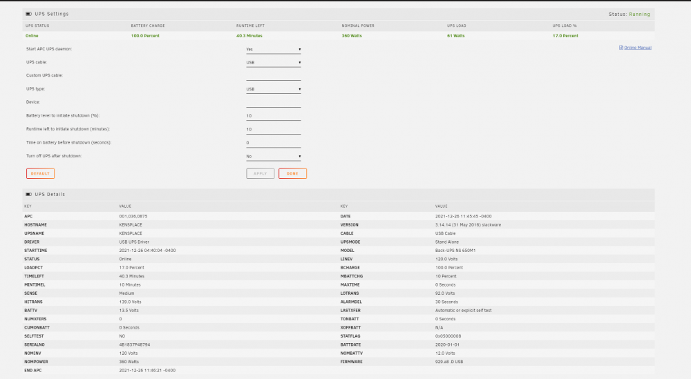

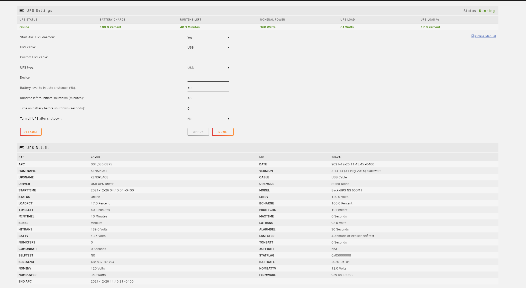

I suspect I may need to lower my sensitivity settings as I have four computers in my computer room. All have their own APC upses. Besides the Unraid server, I have a Linux (Zorin-Os 16) and two Windows 10 Home 64 bit computers. In the APC software I had to lower the sensitivity from high to medium as I was getting warnings of a possible brown out, but the Windows computers remained stable.
Is my assumption of the syslog correct and I need to lower my sensitivity settings?
If so how do I do this in Unraid?
I checked my ups settings in Unraid and see no way to do this?
I did refer to the manual but it is not specific to Unraid and more a generic to Linux.
And I understand editing the ups conf files will not be saved after each Unraid reboot.

Today it's a very windy day in Nova Scotia and we are getting power flucuations. Lights blinking, etc. My Unraid server has been shutting down each time I get a power flucuation however my Windows and Zorin computers have been fine. However in the past I had the same issue with them and had to lower my sensitivity settings for my APC UPSes.
Each computer has their own UPS. Is there a way to lower the UPS settings in Unraid?
Thanks very much...
