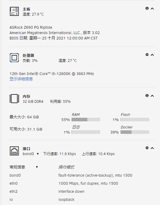

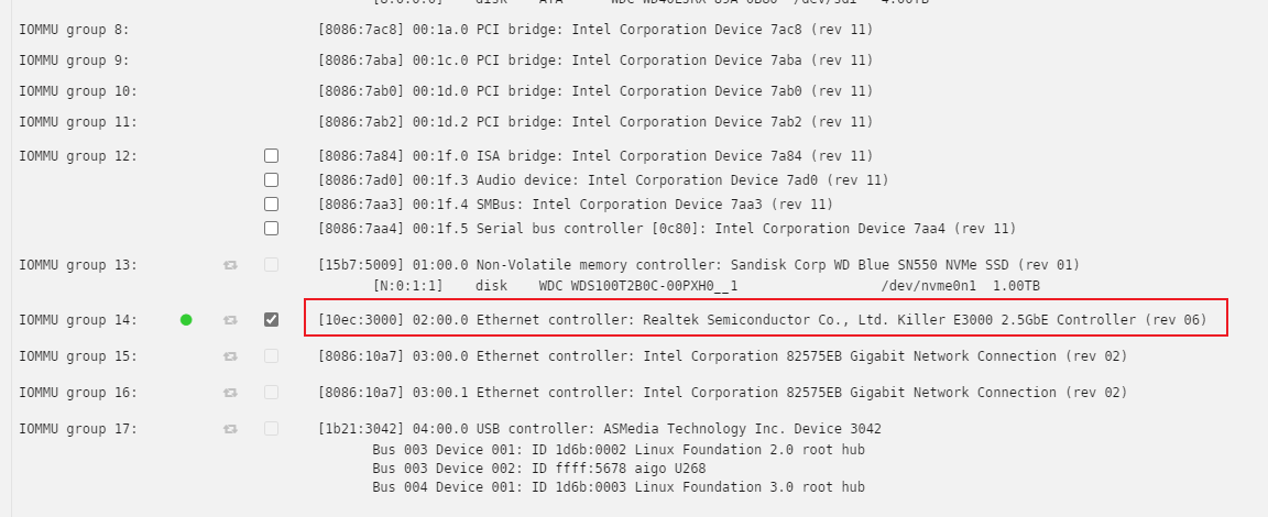

January 22, 20224 yr On 1/10/2022 at 7:17 PM, Acidcliff said: In the end I chose the 12600k with a z690 (MSI PRO A). If it's for interest for somebody: I measured the idle power draw of the pretty "bare bones system*" in a freshly installed win11. It was about 32-38 W(+/-5). * 12600k, MSI Z690 PRO A, PNY XLR8 CS3030 1TB M.2, Arctic Liquid Freeze 420, 3x 140mm fans (all stopped for the test), no OC, XMP on Have yet to test it with unraid installed, but have to overcome some hurdles that came with the platform (e.g. onboard ethernet with intel 225-v not working, need for dedicated GPU since uhd770 has no supported method for sharing between VMs...). Pains of early adopting (or my personal incompetence/ignorance since this is my first build since ~7 years :D) I use the 12600K + ASRock Z690 PG Riptide as solution. ASRock Z690 PG Riptide has 8 SATA3 + 3 M.2 + 1 PCIe 5.0 + 1 PCIe 4.0 + 3 PCIe 3.0 + 2.5G Eth , just RMB 1499 ,about $236.5, so cool !!!
January 22, 20224 yr 18 hours ago, 杨克强 said: I use the 12600K + ASRock Z690 PG Riptide as solution. ASRock Z690 PG Riptide has 8 SATA3 + 3 M.2 + 1 PCIe 5.0 + 1 PCIe 4.0 + 3 PCIe 3.0 + 2.5G Eth , just RMB 1499 ,about $236.5, so cool !!! I am also interested in the PG Riptide. How is the idle power draw? Is the NIC already working?
January 23, 20224 yr 3 hours ago, sylus said: I am also interested in the PG Riptide. How is the idle power draw? Is the NIC already working? NIC are working,i don't the measuring idle power draw,i set 8 4T HHD,1 Nvme,power draw maby a little high 。 Edited January 23, 20224 yr by 杨克强
