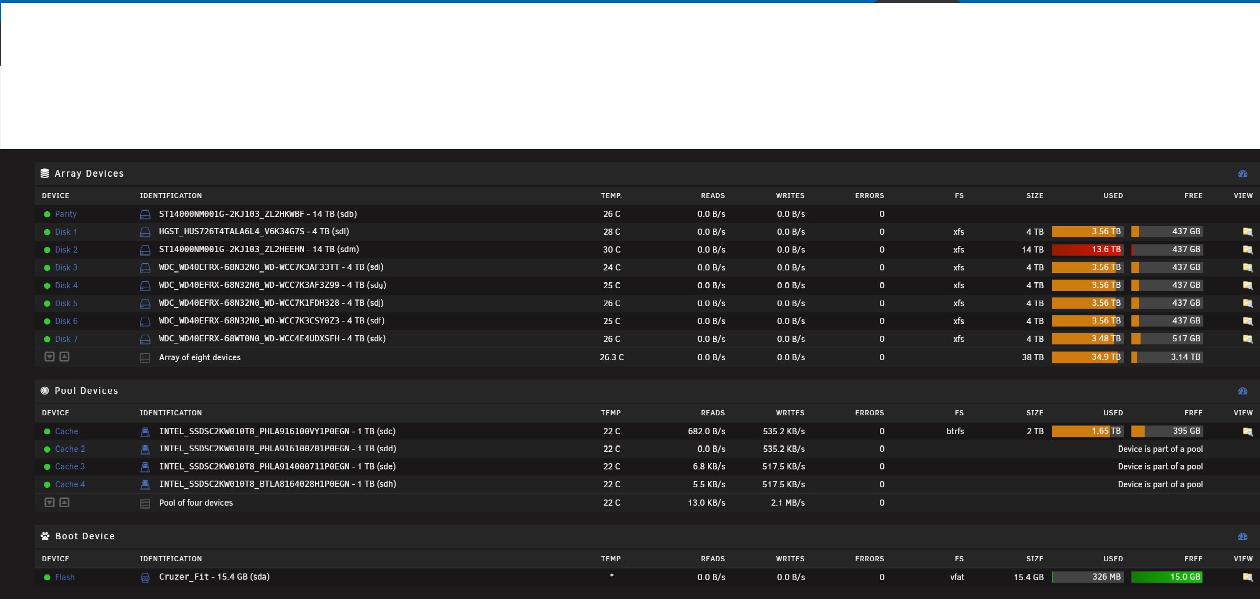

I think this is my first post here! The conversion to unRAID has been smooth. This is such a great community and so much documentation. I did see threads.on this I just wanted to make sure my plan was solid. I currently have an 8 disk array with 7D+1P. I am going to pull out at least 2 maybe 3 smaller disks and replace with 1 larger drive, so I'll have 5 or 6 data disks and 1 parity. All of my internal SATA ports are full.
I was thinking I can pull out one of the data drives to be replaced. Preclear the new drive, let it rebuild from parity. Then shut down dockers and mover then use unbalance to move data from the other drive I will remove. And then remove that drive from the array and run a parity check/write/rebuild... Profit?

Parity drive is 14TB new data drive will be 14TB. Final result would be remove disk 6 (4tb) and 7(4TB), have new 14TB drive as drive 6. Depending how storage look maybe pull disk 5 as well.  If you need any more info please let me know! unraid.thumb.jpg.91f478d24bcb87c5f18317af14efc367.jpg

Every thread I've read says not to worry about "balancing" drives after something like this. Using high water any new data is going to be written to this new drive for quite a while so maybe it isn't as big of a deal but doesn't drive performance degrade as the drive fills? Wouldn't all the drives being 70% filled give better r/w speeds than them being 92% filled?
Yes, especially for reads. For writes, the overhead from Parity makes it less true.
But it really depends on what is on the drives, how often it is accessed and what speed is acceptable.
Most people use Unraid to store data that is accessed very occasionally (media) and for which the speed is not a major issue.
If your use case is different, then this could be useful.
True. It's not often I'm performing a full backup/restore and a 50MBps speed hit when spinning up a 40mbps movie wouldn't even be noticed.
I don't think it would impact my usage but man all that red and orange bothers me haha. I might move one stuff around, I just don't want to cause more harm than good so maybe I won't.
