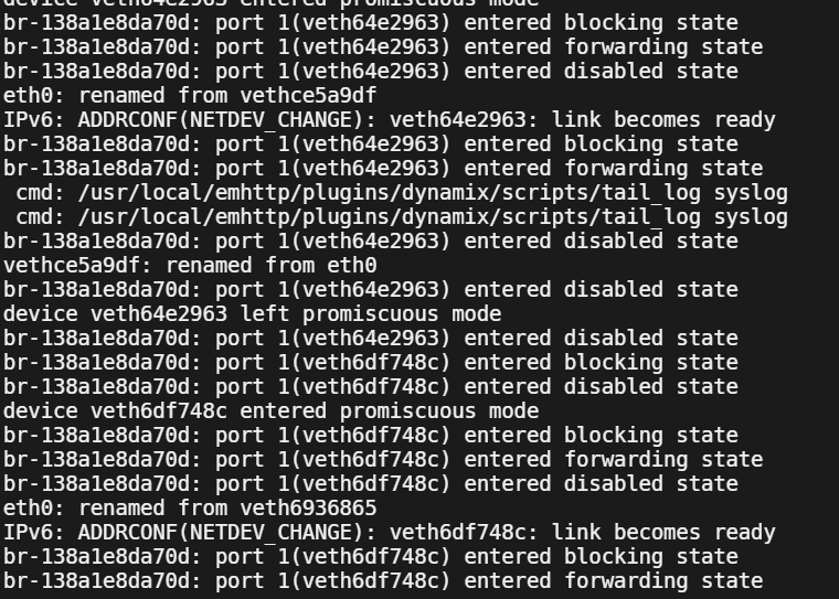

On 1/5/2022 at 4:23 PM, dlandon said:
Stop all your dockers and then start them one at a time to see which one is causing the logging.
also having this problem from proxynet ...
What should i do after finded what docker couse it ?
