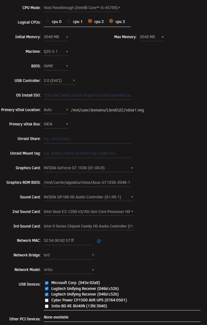

Below a screenshot below of how my LibreELEC vm is configured at the moment
I also just tried using a vbios aswell and also removed all the other sound cards just for trial and error...
Can anybody help me here to get this working please? I'm totally lost right now and really don't understand what's wrong with my setup.
