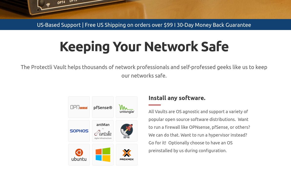

community edition pfsense on protectli???  I've never heard of this
Trying hard not to beat you up too much on this, but this is a screen from the link you posted.
Lmao.  I didn’t even see that.  I was looking at the pre installed options.  Thanks for not beating me up
