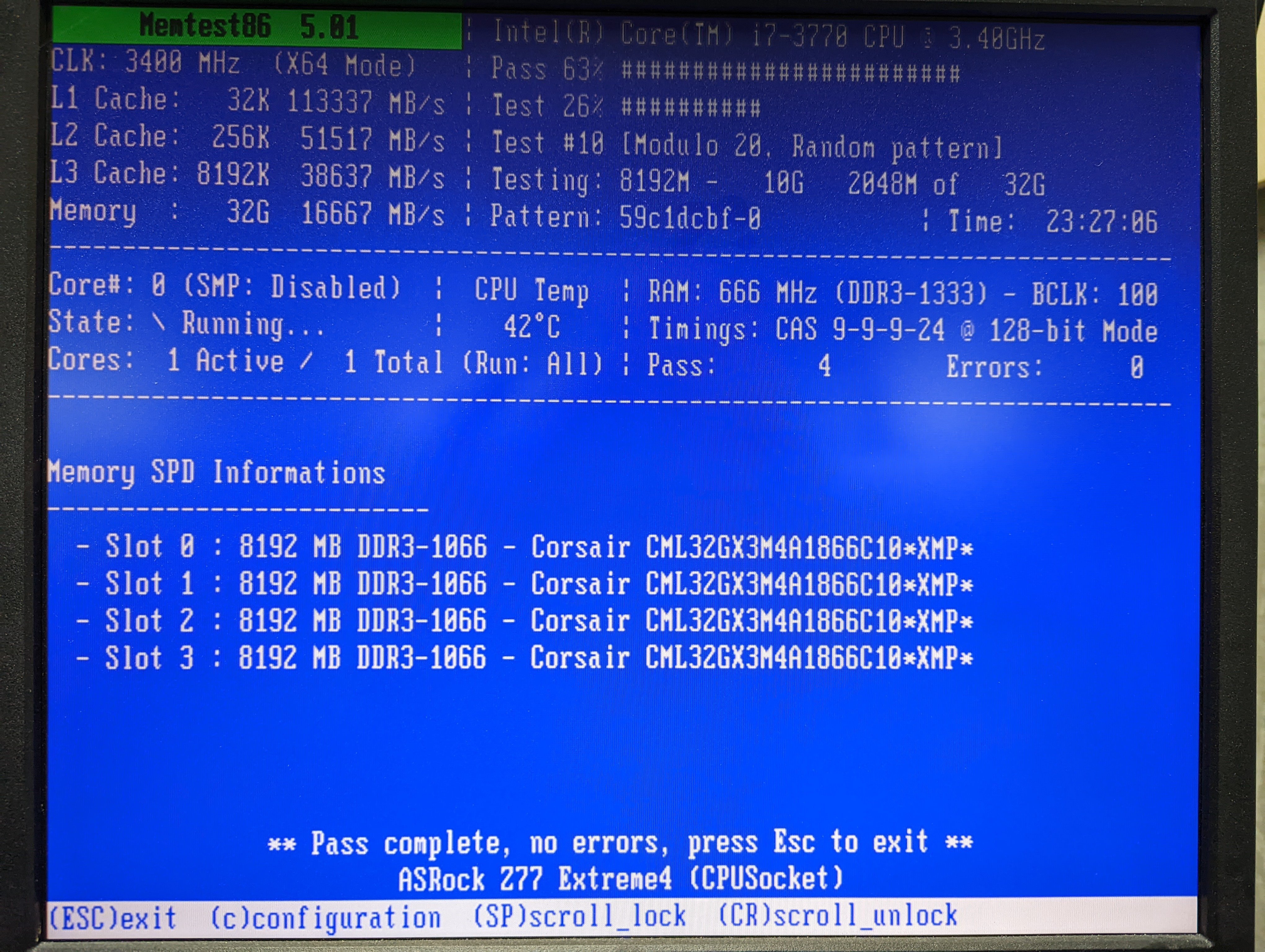

I just started a memtest and can let it run for about 24 hours.  I'll let you know the results tomorrow.
I've had it running for just shy of 24 hours and no errors reported.  Unfortunately, I need to turn the system back on to get access to some files.

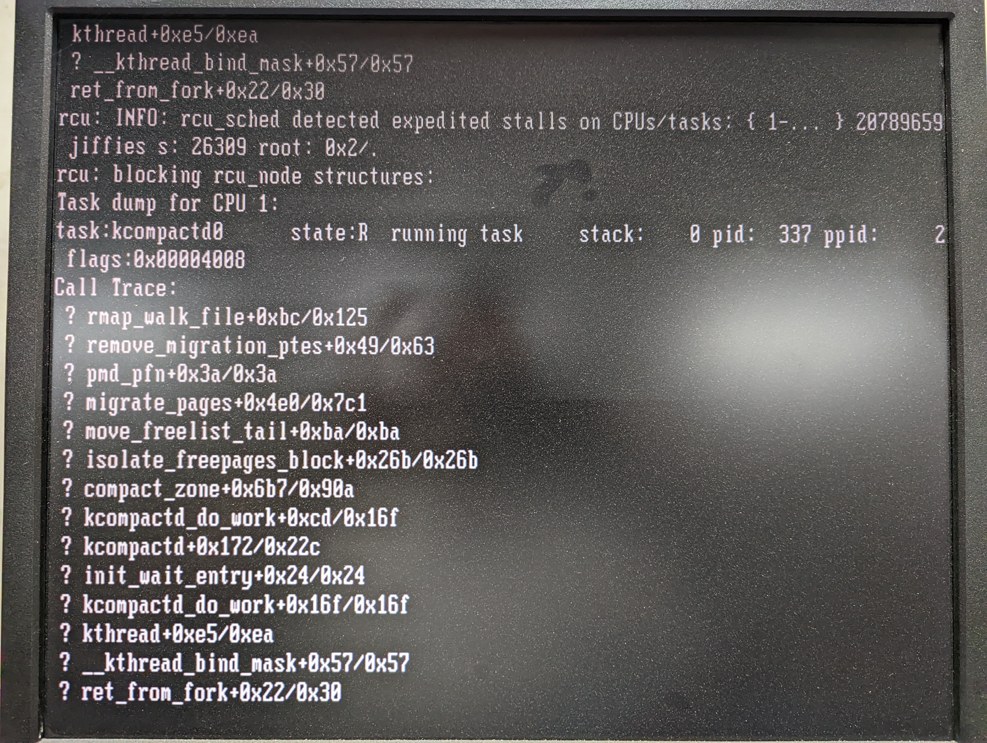

Before powering on the server I removed 2 sticks of memory (slots 1 and 3).  Everything ran fine for a couple of days but then I woke up to the server completely unresponsive remotely.  No ping at all.  Attached is what I saw on the screen.
I came home this morning to the server locked up again (I was able to ping it but the web interface was not responding).  On the screen I saw a message that said:  BTRFS critical (device dm-6): slot 88 key (random numbers) new key (random numbers).
The only BTRFS volumes I have are the cache pool.  Does this indicate an issue with my cache pool raid?
