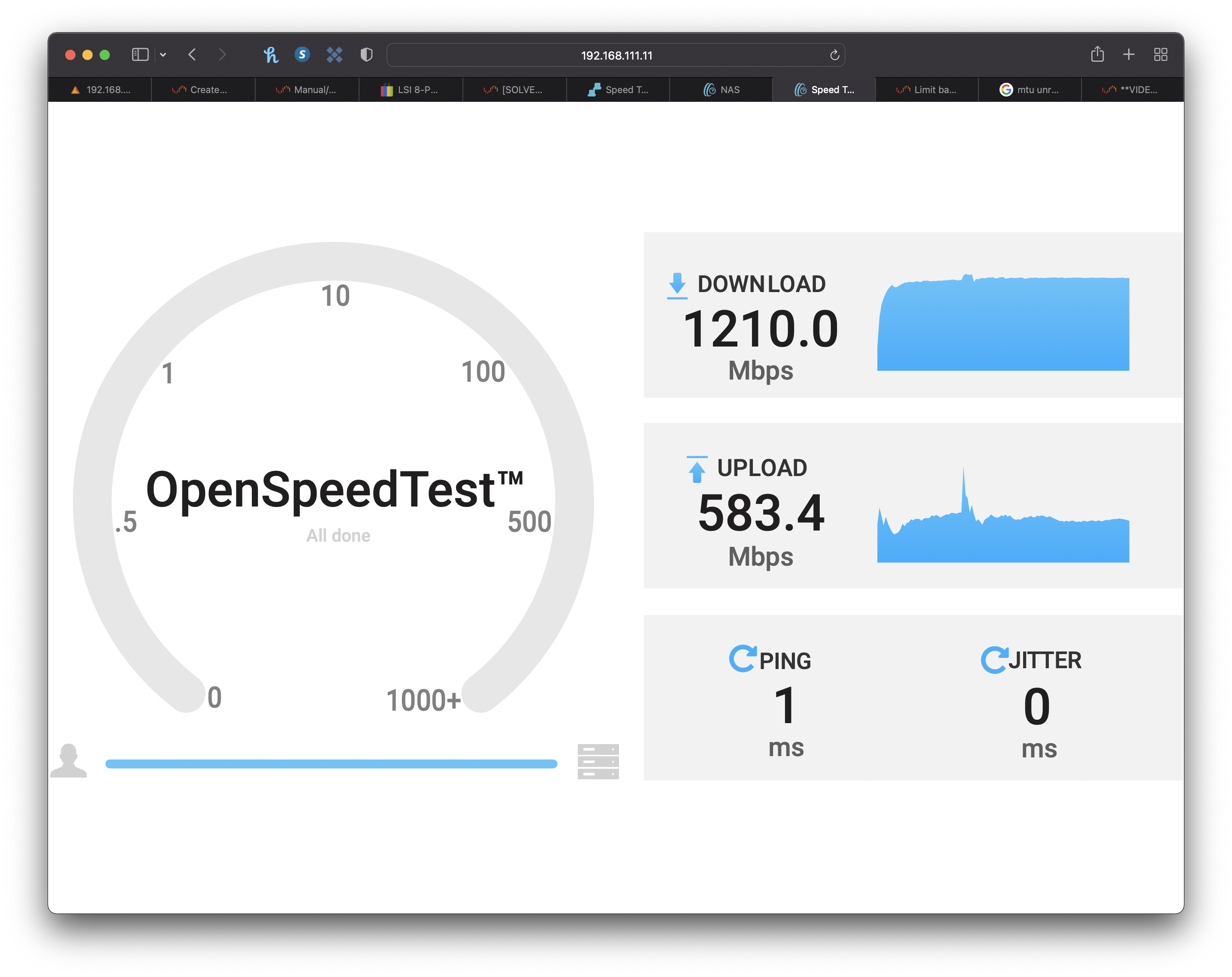

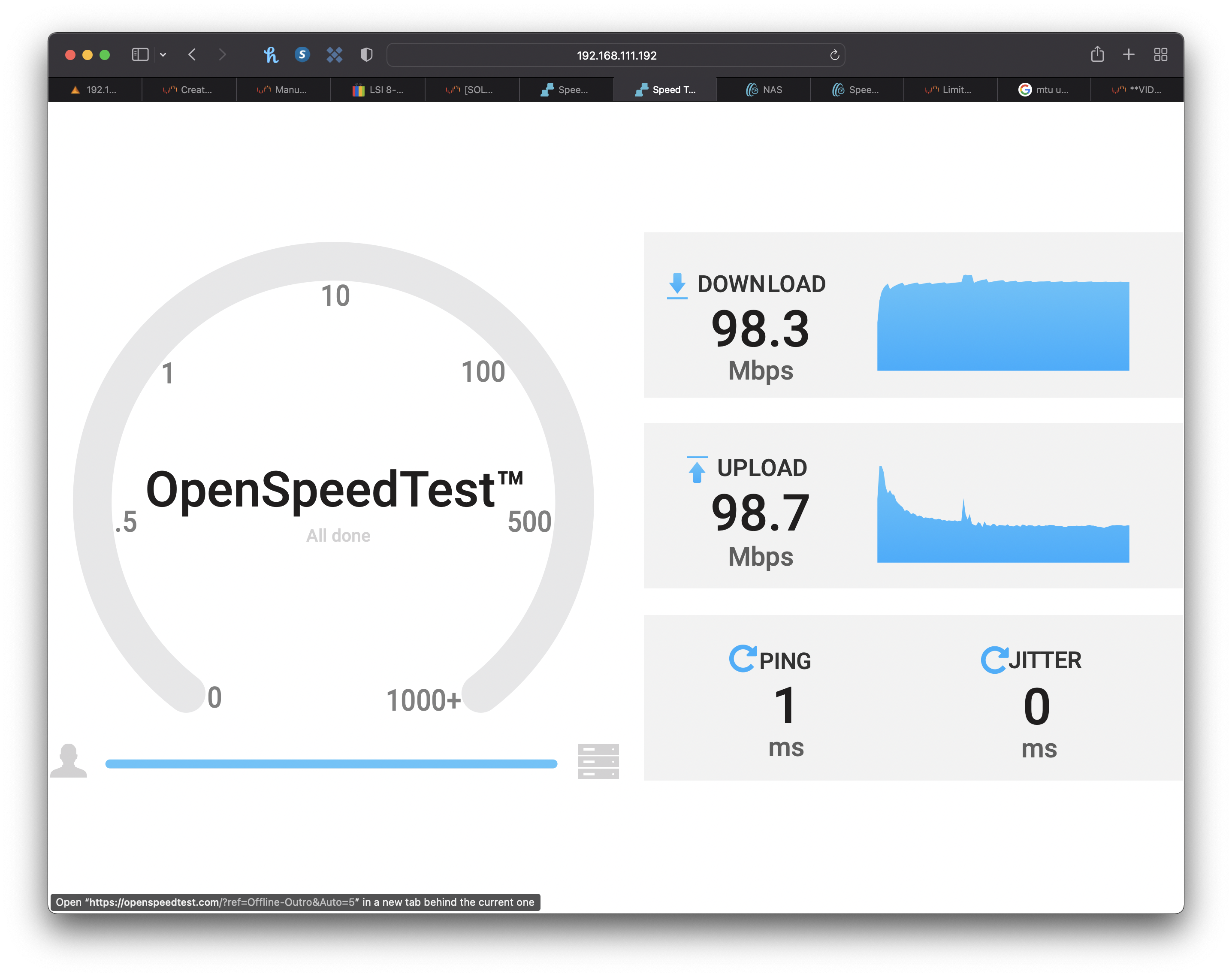

I normally use WiFi (6) to connect to UNRAID and I started to try and figure out if I could get a faster transfer speed. I set up an NVME cache and it made no difference. I tried different file systems and then I just connected a ethernet adapter to my computer and I am STILL limited to 10MB/s. WiFi 6 or hardline is still the same speed. If I connect to my QNAP NAS and run the same OpenSpeedTest docker, I get 30-40MB/s. UNRAID and QNAP are both connected to the same 2.5gbe switch.
It seems that UNRAID is limiting my connection but I can't find any setting that could be causing it. OpenSpeedTest shows a consistent speed right at 10MB/s

I have tried connecting it to the router directly, a 1GBE switch, 2.5GBE switch and now a 10GBE NIC. All result in the same speed of ~100mbps. I will post the results of what you asked shortly.
