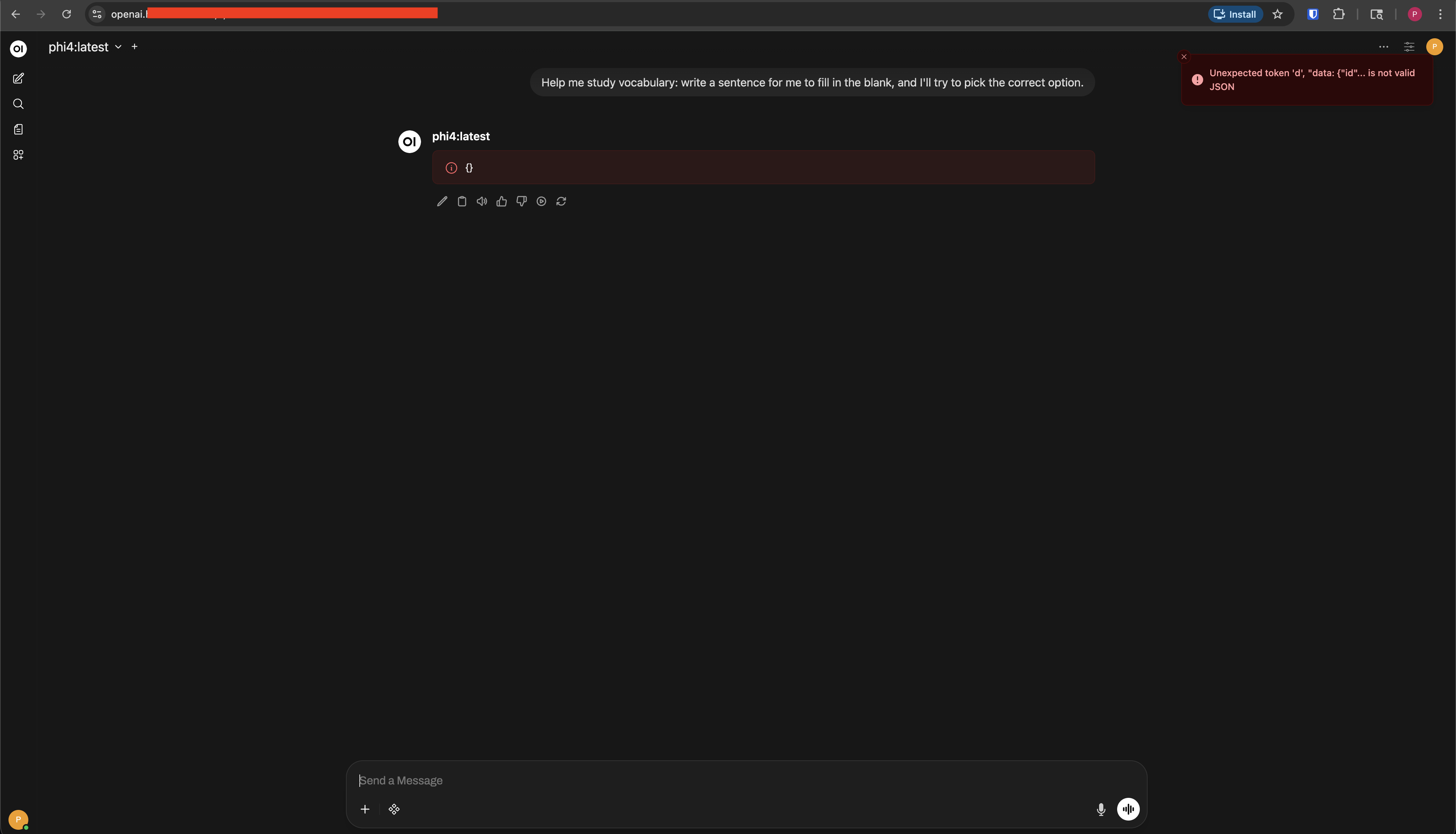

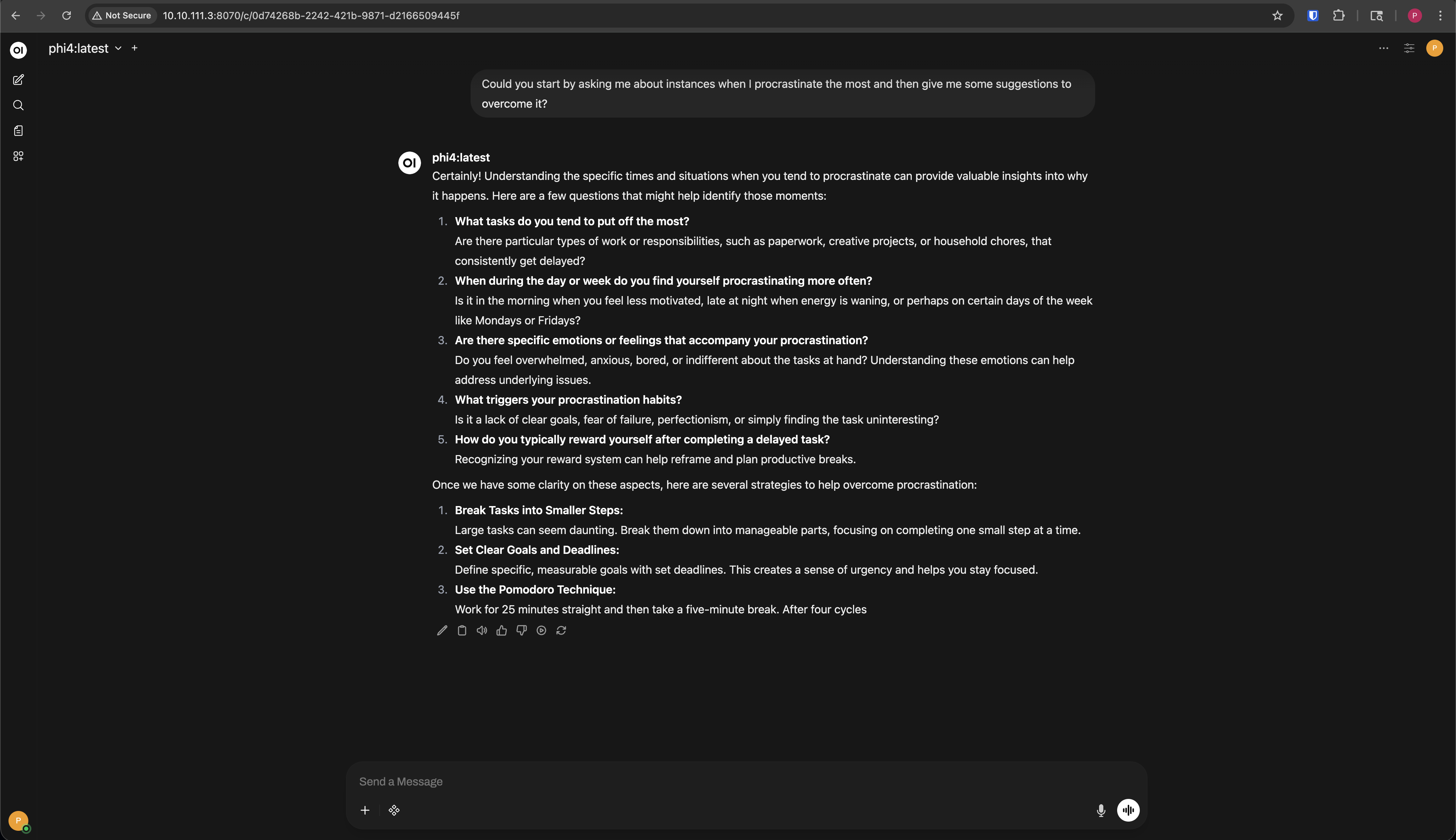

  2. Ok so for anyone that comes across this thread, I was able to solve this issue by disabling the cache function for this domain inside my traefik config. Once that was disabled, it worked without issue just like I was connected directly to the container.
  3. I recently added a NVIDIA GPU to my server with the goal of running local LLM’s. In open webui I added the local connection to my ollama container. If I go to the local address for open webui, I can use the model without issue. I host this as a service with on a subdomain but when I go to the domain it's hosted at, it doesn't work. I get an error with just brackets.

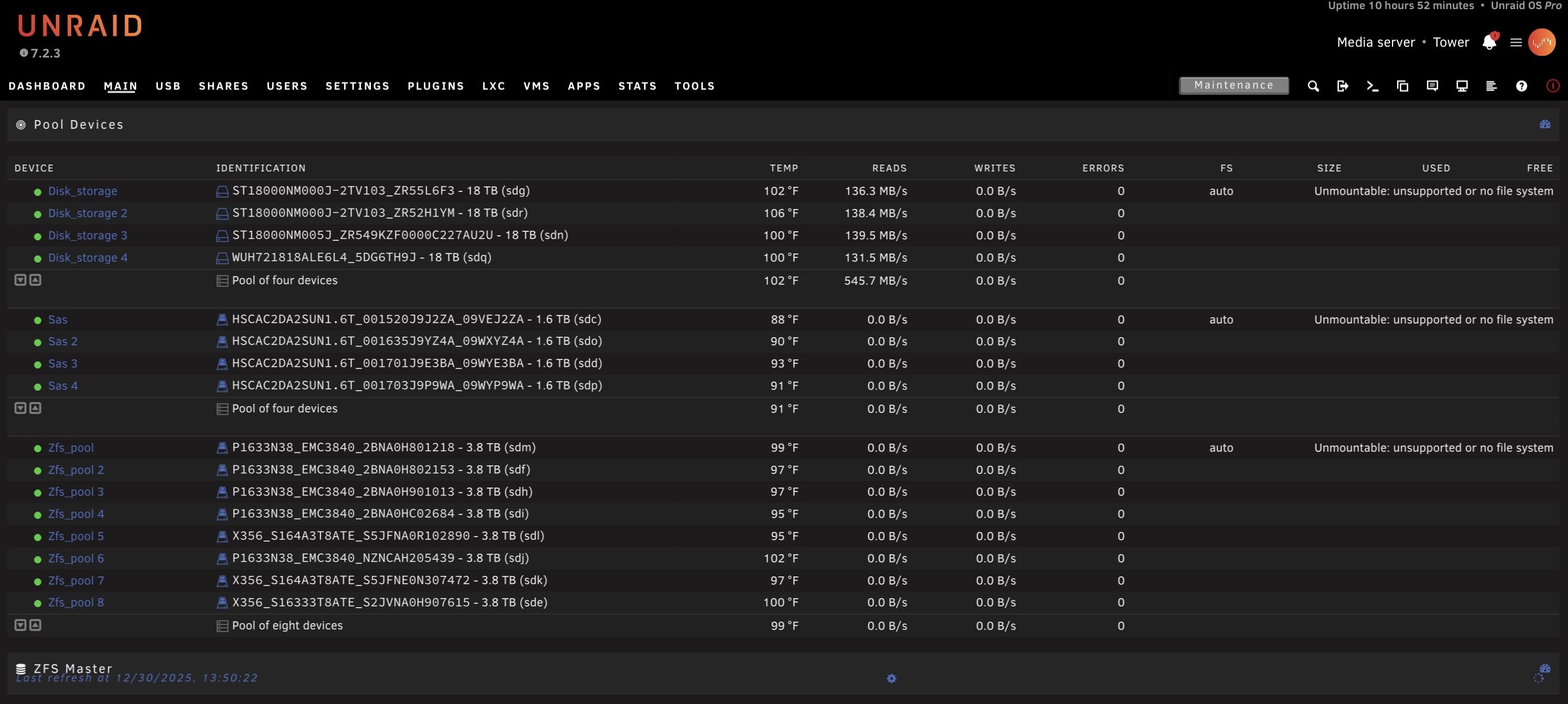

  5. Ok, I figured it out. I had to export all pools then restart the server. Since the sas and disk_storage pools already had the drives assigned to them, the pools populated correctly and I just had to format the zfs_pool drives and I’m back up and running like I wanted.
  6. I tried this and it says they’re unmountable. I’m not worried about the zfs_pool since I have to rebuild it but the other pool (sas and disk_storage) I can’t reformat them without loosing data,
  7. My goal was to remove four drives from a pool. I have a total of three pools. disk_storage: 4x 18TB drives sas: 4x 1.6TB drives zfs_pool: 12x 3.84 drives (this is the one I wanted to remove four drives from to make it 8 drives. I copied all the data from the zfs_pool to the disk_storage pool to back it up. Then I removed the four drives and made a new config but I was expecting to see the option to keep all the pool assignments, and then I would just remove the four drives and transfer the data back into the pool. I think this is where I went wrong. Afterwards, no pools are displayed in the GUI but the pools are intact in ZFS master and in the CLI. How do I get the pools to show as they did before on the main tab, with each pool with each associated drive under it?
