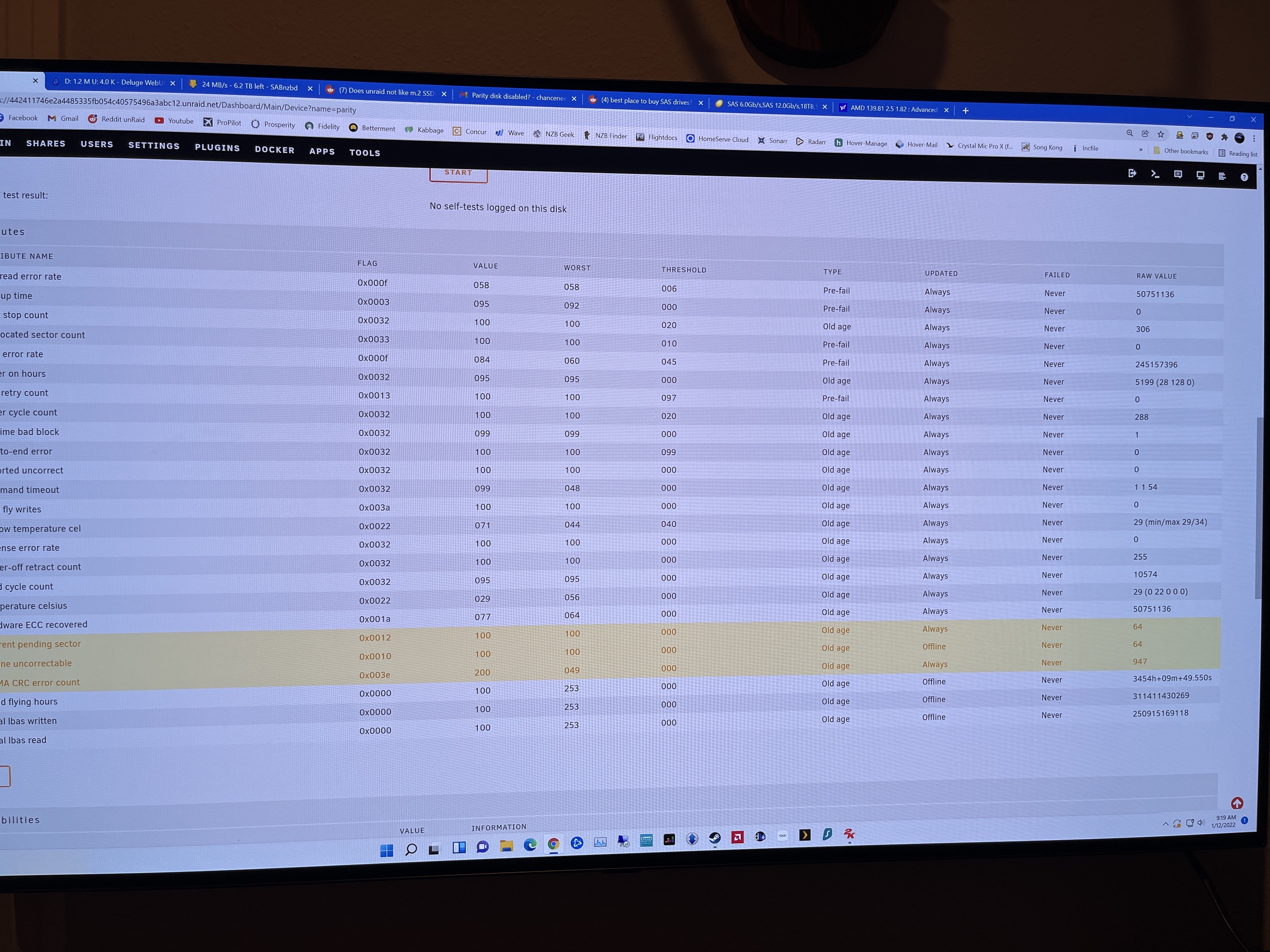

On the dashboard page for the failed parity drive the smart data under “failed” says never for everything.  Sorry you caught me as I was using my phone and wanted to get this quickly lolimage.thumb.jpg.840eff709ed9943fb6566162b61f55f6.jpg
Technically this is not a fatal error so those attributes being non-zero is not listed as failed in the attributes, but they are an extremely bad sign.   As a general rule if SMART marks anything as failing then the drive should be changed ASAP, but the converse does not necessarily mean there is no problem.

I’m a newbie so when you say SMART marks a drive as failing, where are you looking? Is it because they’re highlighted in yellow?
If it is marked as failing in the FAILEd column then the drive should be considered as having a fatal error.   A failed extended SMART test is also considered fatal.  If it is highlighted in the Unraid GUI then can just mean it is one being monitored by Unraid and you need to look carefully at this attribute - especially if it keeps getting worse.

That is not the Dashboard page, and I was asking about your other disks since you didn't notice there was anything wrong with this one.
Also, screenshots are very much preferred over photos.
